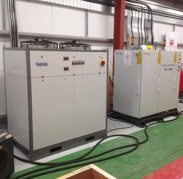

Installation of the laser (right) and its chiller (left) on site - after a 500 miles plus road trip.

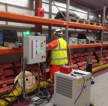

TWI-manufactured system safety control unit in site use.

Following these lab trials, a TWI project team was assembled with expertise in laser engineering, electrical system engineering and component design. This team developed a concept for a Class 1 laser site welding system, in discussion with TechnipFMC and another of its subcontractors. The team’s combined experience, backed up by impartial third-party laser safety oversight, ensured that the concept was in line with relevant ISO and IEC laser and machine safety standards.
  • After a concept review, including a comprehensive documented failure modes and effects analysis (FMEA), TWI produced a full set of engineering and electrical drawings for the bespoke mechanical and control components of the system, compatible with the other commercially available laser equipment needed to complete the system.
  • With client approval of these drawings, the bespoke components were then manufactured by TWI’s machine shop and electrical services group, who also went on to support TWI’s lasers team with their integration in to the overall system, ready for lab testing.
  • Lab acceptance testing of the system was then successfully carried out, as witnessed and signed off by the client and an independent third-party laser safety consultant. The system was tested on mock pipes, at a scale representative of its final application. This testing confirmed the positive transfer of the previous lab conditions, meeting client weld quality and performance requirements. This testing also usefully highlighted a small number of remaining snagging points for smooth system operation, which were then easily rectified by TWI before final system completion.
With the acceptance phase of the project fully completed, the different elements of the system were then road-transported to TechnipFMC’s site on the Cromarty Firth in Scotland, for the follow-up site integration test.

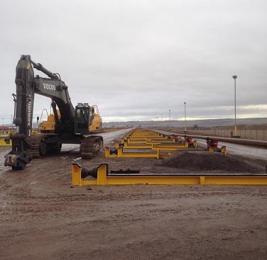

Whilst the nature of the site work carried out remains confidential, this article can share the snapshots shown of that work, and report that the integration, and its results, were successful, fully meeting client expectations.

Pipe on site, on which the laser welding work was carried out.
