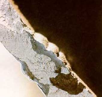

Examination of the fracture faces in the tank shell showed them to be flat and perpendicular to the plate surfaces, with the characteristic chevron markings of brittle fracture (see Fig.). The chevron markings pointed back to a flaw below the weld between the 1st and 2nd courses, at the point where a vertical weld on the 2nd course met the circumferential weld. The flaw was described as being 'dime-size' or about the size of a 5 pence piece and its orientation was in the vertical direction of the tank. Metallographic studies of the flaw revealed it to be due to flame cutting, rather than welding but, surprisingly, not the flame cutting of the dismantling procedure. The flaw had been present in the steel plate prior to being welded when the tank was originally built.
Charpy V notch tests and drop-weight tests (Pellini) to measure the nil-ductility transition (NDT) temperature were performed on the shell plate. The parent material was an ASTM A10 steel, either rimmed or semi-killed. The NDT temperature was found to be +10°C and at +3°C, the estimated temperature of the tank wall at failure, the Charpy tests showed low energy absorption. However, engineering defect assessments using fracture toughness values measured at +3°C indicated that the stress due to the hydrostatic pressure alone (approximately 80N/mm 2) would not have been sufficient to trigger failure. Soil foundation analyses were carried out which ruled out subsidence as a contributory factor.
Attention was then turned to the influence that the weld adjacent to the flaw may have had. Welding residual stresses may be as high as yield strength level. In the case of the Ashland tank this could have meant that the flaw was subject to a stress level of approximately 240N/mm 2. Furthermore, the effect of the welding heat cycle on the material at the crack tip was thought to have caused locally intensified strain-ageing embrittlement to which steels of this type and vintage are susceptible. This was confirmed when low fracture toughness values were measured on shell plate samples simulating this form of embrittlement.
It was finally concluded that the failure was due to the material immediately surrounding the flaw being of particularly low toughness, with crack initiation occurring under the combined effect of hydrostatic and residual stresses. As the tank was operating below the NDT temperature of the shell plate, the crack emerging from the locally embrittled area could not be arrested.

Ashland storage tank (fracture face) (Reproduced courtesy of Ashland Petroleum Co and Battelle Columbus Division)
