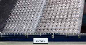

The joining option studied in this investigation is based on a revolutionary new material processing technology, known as Surfi-Sculpt®, developed by TWI, UK.[7,8] Using an electron beam (EB), a material can be processed to give a number of different types of surface topography. EB can reshape materials precisely, 'growing' protrusions that rise from the surface of the material. Such transversely oriented protrusions are capable of improving the mechanical performance of the bonded joints.
Figure 1 illustrates the protrusion pattern selected and employed for the novel hybrid joints.
Fig.1. Image of protruded metal surface

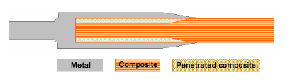

A refined Comeld concept applicable to prospective hybrid hull structures has been delineated and explored during the reported investigation. Specifically, the original Comeld concept has been reconfigured so that metal 'catch' plates embrace the composite detail. Forming a bonded-pinned metal-composite sandwich that is stiffer and stronger with increased load-bearing capability under transverse bending.
In addition, the metal catch plates protect the penetrated composite from a direct impact, improving the joint impact damage resistance.
Figure 2 represents the selected joint configuration referred henceforth as 'Comeld-2' or 'bonded-pinned joint' to avoid any confusion.
Fig.2. Comeld-2 bonded-pinned joint configuration

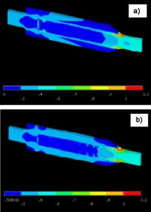

Specifically, two similar heterogeneous parametric FE models comprising second order solid elements, both isotropic and orthotropic relevant to the joint components were built, debugged, and run employing ANSYS FE software. One model represents the base-line bonded-only joint and another has protruding features on the contact metal surface which penetrate the composite.
The protrusion was modeled with idealized cylindrical pins, the main dimensions of which correspond to those of the real protrusion. Parameters of the model were varied to reflect design features of the studied joints and to assess the influence of these factors on a joint's performance.
Due to the structural and loading symmetry, only half of a joint model was subjected to the computation. A model free from lateral constraint was used to reflect the boundary conditions intrinsic to the intended tensile testing.
Assorted failure modes were applied to heterogeneous structural assemblies. Hybrid joints undergo a variety of loading exposures in-service. Depending upon the joint design, each of a joint's components may represent a weak link able to initiate a failure of the entire joint structure.
In general, a joint's failure onset might occur as a result of a rupture or delamination of the composite detail, its debonding from the metal, fiber fracture due to stress concentration within a zone of structural irregularity (e.g., at the tip of the metal overlap and/or nearby a pin insertion), metal cracking within weld and/or other stress concentration areas.
Therefore, an integral strength criterion had to be employed to reconcile individual strengths of joint components against the given design and operational requirements. The condition incorporates non-dimensional stress indices relevant to the joint structural components: composite (C), metal (M), and bonding film (B). Here ΨCΨ MΨB are the indexes characterizing stress intensity of each component relatively to either specified allowable design stress or ultimate strength of the utilized materials.
The criterion (1) accompanied with utilization of various failure criteria relevant to the assortment of component materials and possible failure modes were applied to assess the joints performance under test loading.
Figure 3 illustrates the results of the FE simulation displaying variation of the maximal stress index Ψmax over the joint longitudinal cross section.
Fig.3. Failure index: a) Bonded-only joint b) Bonded-pinned joint
[1]
[1]
As can be seen, the metallic catch plates within the bonded-pinned joint experience notably higher loading intensity than those in the bonded-only joint. Presumably, that is due to the pinning, which helps to intensify the load-sharing between the metal and composite structural components. In fact, this is the main advantage of the bonded-pinned joint option over the bonded-only joint which enables the sought increase of the joint's load-bearing capability.
Overall, the computer simulations provided useful information on the joint's structural response to the tensile loading and helped to identify the joint's critical areas prone to crack initiations. To verify the model validity and obtain the actual data on feasibility and structural efficiency of the selected Comeld-2 hybrid joint concept, mechanical testing of pilot joint articles were performed.

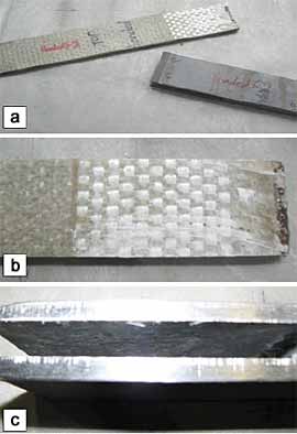

Outwardly, all tested joints appeared to have a similar failure mode: double shear of the composite being pulled out of the metal fork formed by the capture plates. However, fractographic analysis revealed that the two tested joint configurations (bonded-pinned vs. bonded-only) had slightly different failure modes.
Figure 5 and Figure 6 illustrate this regarding bonded-only and bonded-pinned joints, respectively.
As shown in Figure 5, the bonded-only joint exhibits a mainly cohesive failure typical of well prepared composite-to-metal.
Fig.5. Bonded-only joint failure a) Separated composite and metal details b) Composite surface c) Metal surface
Fig.6. Bonded-pinned joint failure a) Composite surface b) Metal surface
The failure of the bonded-pinned joints (Figure 6) is also cohesive in nature, but this is accompanied by partially sheared off and bent and plastically deformed pins. The composite beyond the pins shows no signs of cohesive failure which implies lowered contribution of this area to the load-bearing of the overall joint.
