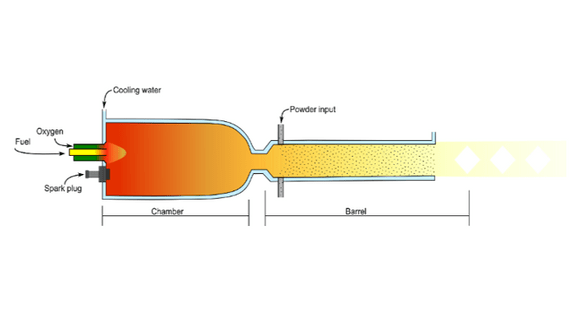

HVOF spraying was developed in the 1980s and is one of the most-applied thermal spray processes. It works by mixing fuel and oxygen, which is fed into a combustion chamber and ignited. The combustion of gases produces a high temperature (2500-3200°C) and pressure in the chamber, which is ejected through a nozzle at supersonic speeds (Figure 1). This velocity may reach values near 2000m/s (for HVOF) in contrast to about 100 m/s for flame spraying or 1000m/s for plasma spraying. This can result in dense and good adherent coatings. Thus, it is largely used for applying powder materials with a relatively low melting point and those that are subjected to thermal degradation at high temperature [1].
Figure 1. Schematic diagram of HVOF process

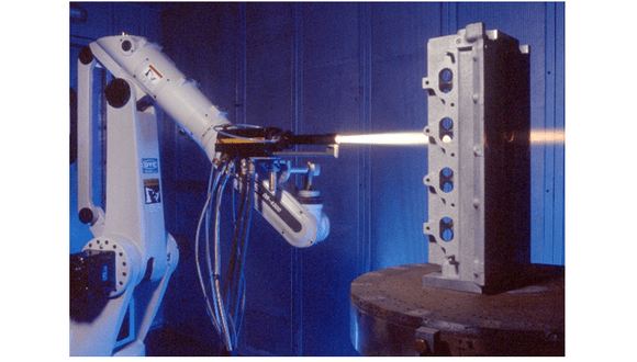

HVOF is primarily used to deposit cements, metals and alloy coatings, such as WC-CoCr, WC-Ni, CrC-NiCr, Ni alloys and steels. HVOF also demonstrated capability in depositing dense ceramic coatings such as hydroxyapatite, Al2O3, ZrO2, Cr2O3. Coating thickness is usually in the range 0.1-2mm and with porosity typically lower than 2.0 vol%. These coatings can be used across a range of engineering and manufacturing applications to enhance surface properties of components to enable cost-effective and high-performance approaches. This can include, but is not limited to, protecting surfaces against wear, friction and/corrosion, biocompatible layers, oxidation resistance, electrical insulation, and repair of damaged components.
A wide range of HVOF coatings, including both cermet coatings and alloy coatings, are deposited by TWI Ltd (Figure 2) to explore their possibility in protecting drilling components in Geo-Drill.
