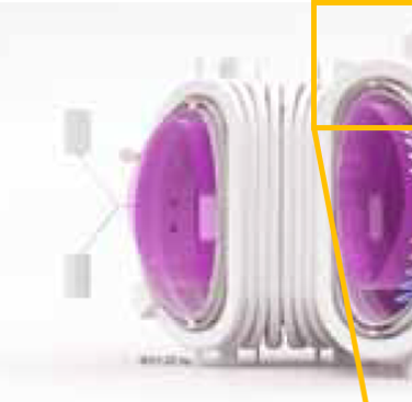

Schematic of one design of a nuclear fusion reactor, highlighting an example of in-bore pipe maintenance requirements (circled)

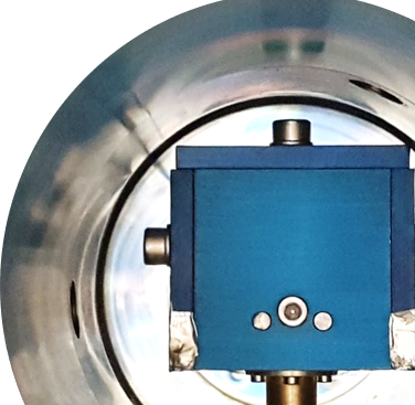

Example of a RACE-designed miniaturised in-bore laser processing head
Head inserted (robotically) into a 90mm bore pipe, prior to initiation of processing

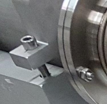

Pipe cutting rig (top), cut coupons (middle) and integrated in-bore cutting tool (bottom)

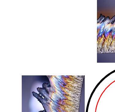

Example of an orbital through-thickness cut in 5mm wall thickness stainless steel pipe
Example of an orbital weld made between two 3mm wall thickness stainless steel pipe sections and (inset) a typical weld cross-section
