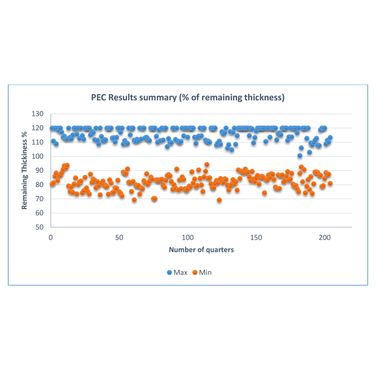

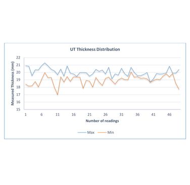

The recommended solution to address the integrity of external corrosion damage on the pipelines beneath the concrete coating was a thorough, 100% coverage, pulsed eddy current (PEC) inspection followed by an ultrasonic thickness measurement of the reported anomalies.

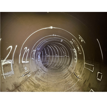

A full-coverage inspection was conducted of both pipelines internally to identify the pipeline conditions against identified threats and damage mechanisms. A number of priority parameters were set during the inspections to make sure the integrity approach was accurate.
Three inspection methods were used concurrently to determine the integrity of the pipes, with an emphasis on the external surfaces, since these are the areas most susceptible to corrosion:
  • Visual inspection (VI):
  • Pulse Eddy Current inspection (PEC)
  • Ultrasonic Thickness Measurement (UTTM)

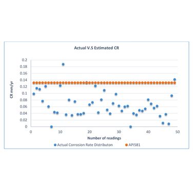

The results of the assessment showed that the pipelines were generally in good condition, despite a few corrosion monitoring locations being identified for NDT inspection at recommended intervals. The conclusion of the results indicates that, while the CP system could not be checked, it is working efficiently on both pipelines and providing an acceptable level of protection and keeping the external corrosion rate below the theoretically expected rate. Inspection intervals of 5 years and 10 years were recommended for the pipelines.

Figure 3. Distribution of the minimum and maximum measured PEC Inspection Results alongside the pipe (inspection zones and quarters)
Figure 4. Distribution of the remaining wall thickness along the pipe with minimum and maximum measured wall thickness data using UTTM grid scanning at the identified location (reported from PEC inspection)
Figure 5. Comparison of Theoretically Estimated Corrosion Rate against the Actual Calculated Corrosion Rate
