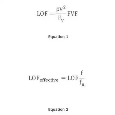

The likelihood of failure of a piping system when flow-induced turbulence is the excitation mechanism is governed by two conditions: flow-induced vibration factor (Fv) and dynamic pressure (ρv2).
The flow-induced vibration factor is calculated from the geometric properties of the pipe being inspected. The external pipe diameter (Dext) and the wall thickness of main pipe (T) are used to calculate the  and  for a particular piping support arrangement, as specified in the aforementioned EI guidelines.
The dynamic pressure is determined from the flow properties of the fluid system. It depends on parameters such as density or fluid velocity.
The likelihood of failure for flow-induced turbulence is then calculated using equation 1.
The calculated LOF for the respective piping system is then integrated with online measurement data to determine the effective LOF. This is done by measuring the vibration level against the predefined natural frequency, as in equation 2.

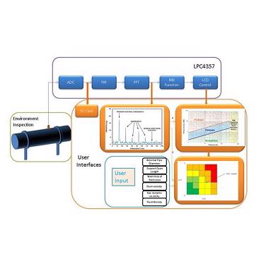

The system strategy is described in Figure 1:
The testing environment, as defined by the operator, will determine which parameters are used. These could include the external pipe diameter, support span length, wall thickness of main pipe, fluid velocity, gas dynamic viscosity and fluid density.

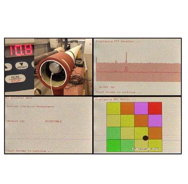

The system prototype comprises a vibration signal sensor and an assessment module. A touchscreen interface allows the operator to enter the pipe and fluid details. Once the vibration data is acquired, the functions can be calculated either in real-time or using offline advanced data processing.
The system is able to plot both the acceleration and the frequency spectrum, enabling the detection of dominant peak frequencies. This allows the initial vibration assessment to be determined and the LOF for flow-induced turbulence to be calculated and plotted on the risk-based inspection matrix (Figure 2).

Figure 1: The different modules of the system including the user interface and the MEMS Accelerometer ADXL325

Figure 2: Display of the LOF in the risk matrix for vibration induced by rotating motor with embedded unbalance
