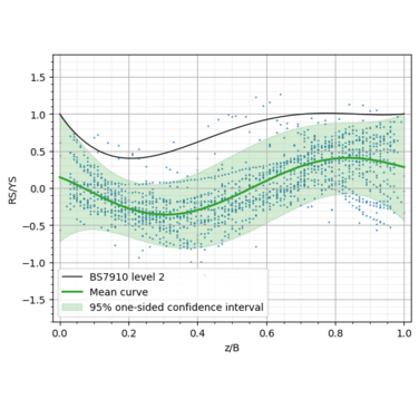

Figure 1. The mean curve for low heat input residual stress along with the 95% one-sided confidence interval plotted with the BS7910 level 2 upper bound fit

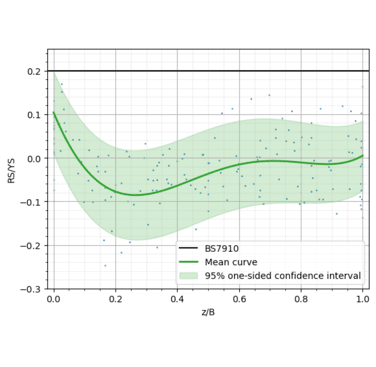

The research showed that the BS 7910 level 2 curve for low heat inputs is conservative with respect to 95% one-sided confidence. Similarly, when PWHT has been applied, the BS 7910 guidance to use 20% of the lesser of the yield strengths of the weld or parent metal is conservative with respect to 95% one-sided confidence.
Overall, this research showed an improved and systematic approach to probabilistic modelling of residual stress compared to previous, conventional methods.
Figure 2. The mean curve for post-weld heat treated residual stress along with the 95% one-sided confidence interval plotted with the BS7910 advice to use 20% of yield strength
