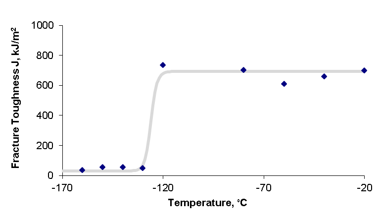

4.2 Fracture Toughness Test Results and Transition Curve Fitting
The results of the fracture toughness tests were plotted as values of fracture toughness in terms of J, against temperature, and a curve fit of the form of a tanh function was fitted to the data as a best fit by eye to define the ductile to brittle transition curve. The S-shaped tanh function is a curve of the form:
J= X + Y tanh ( (T-T0) / Z)                                           (1)
where X, Y, Z and T0 are the curve fitting parameters. The parameter ‘X’ defines the fracture toughness halfway between the upper and lower shelves, and T0 is the temperature of this mid-transition point X. The parameter T0 is therefore also defined as the ductile to brittle transition temperature from the tanh fit. The parameter ‘Y’ defines the magnitude of the difference between upper and lower shelf fracture toughness, where X+Y is the upper shelf fracture toughness and X-Y is the lower shelf fracture toughness. The parameter ‘Z’ is a measure of the steepness of the slope of the transition, and gives the temperature range over which the fracture toughness changes from X-½Y to X+½Y.
The results of the fracture toughness tests in steel M01 are given in Table 2; the SENB and SENT test results are plotted in Figs. 6 and 7 respectively. The test results for steel M02 are given in Table 3 and the SENB and SENT test results are plotted in Figs. 8 and 9 respectively. The test results for weld W03 are given in Table 4 and the SENB and SENT test results are plotted in Figs 10 and 11 respectively. A comparison of all the transition curves is given in Fig. 12 for all three materials and both specimen types. The upper shelf SENT specimens from M01 and M02 (identified by an asterisk in the tables) showed some out-of-plane tearing on their fracture surfaces, with a tearing angle of up to 50° (Fig. 13), therefore the values of J determined from these tests have been corrected by multiplying by the cosine of 50° (0.6428) for the tanh curve fitting [13].
The tanh function fitting parameters for each of the transition curves shown in Figs. 6-11 are given in Table 5. Charpy transition curves were generated for the three materials as well, and although not plotted against the same vertical toughness scale, the fitting parameters giving steepness of the transition and the transition temperature (also given in Table 5) can be compared to the SENB and SENT results.

Figure 7 Fracture toughness data and transition curve for steel M01 using SENT specimens

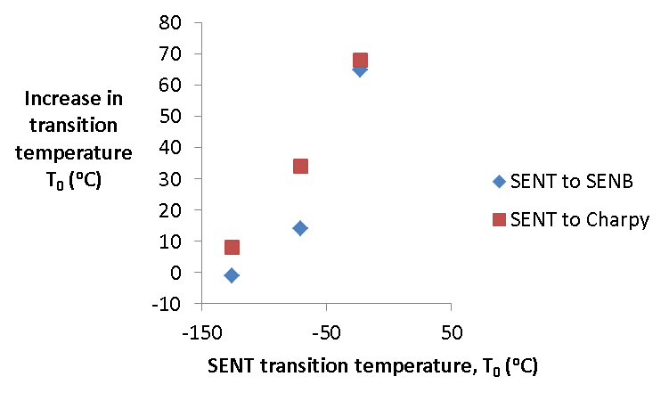

Figure 12 Comparison of SENT and SENB transition curves in three different steels

Table 5 Tanh function fitting parameters for the ductile to brittle curves in the three materials, for fracture toughness in terms of J (kJ/m2) and Charpy in terms of impact energy (J).
Data set X Y
Z
T0, °C
M01 SENB 236 184
5
-127
M01 SENT 362 331
3
-126
M01 Charpy 73 45
26
-92
M02 SENB 206 180
32
+42
M02 SENT 297 272
5
-23
M02 Charpy 62 49
53
+45
W03 SENB 142 131
11
-57
W03 SENT 336 289
2
-71
W03 Charpy 95 91
20
-63

5.1 Transition Curve Behaviour with SENT Specimens
A wide range of ductile to brittle transition temperatures were shown by the three steels that were characterised in this work. The transition curves were fitted to quite scattered data in some instances, particularly for weld W03, which may be due to greater inhomogeneity in the weld metal sampled between specimens. An average-fit transition curve was used for this work to compare the different materials. Had a lower-bound transition curve been the intention, then the curve fit parameters might have been slightly different to those given in Table 5. The values of transition temperature, T0, from the SENB specimens ranged from +42°C for M02, to -127°C for M01. Yet for these three very different types of steel, there were some common features between the SENT transition curves for all of them.
All three materials showed upper shelf fracture toughness values in the SENT specimens of at least 150kJ/m2 greater than the SENB values. Care must be taken in the interpretation of upper shelf SENT results where there is out of plane tearing [4], the data presented here was corrected for out-of-plane tearing in some specimens in M01 and M02 based on the tearing angle [13]. The higher fracture toughness in SENT specimens is the well-known consequence of the difference in constraint between the SENB and the SENT specimen, and the reason why SENT specimens are so widely preferred, particularly for pipeline and high strain applications. The difference in lower shelf fracture toughness in terms of J was less significant, the SENT being within 40 kJ/m2 of the SENB value in all cases, and it was less than the SENB lower shelf for M01. These results agree with similar findings by Hauge and Holm [6] who also found little difference in lower shelf behaviour, but significant difference in transition and upper shelf between SENB and SENT.
For two of the materials, M02 and W03, there was a difference between the transition temperature of the SENB specimens and the SENTs, with the SENT specimens giving a lower ductile to brittle transition than the SENBs, but for material M01 the transition temperature was almost the same for both SENT and SENB specimens. The transition temperature determined from the Charpy transition curves was closer to the SENB transition temperature for M02 and W03, but not very close to either for M01. The difference in T0 between the SENT and SENB specimens, and the SENT and Charpy specimens, plotted against the SENT transition temperature, T0, is shown in Fig. 18. This trend suggests that the relative transition temperatures between SENT and SENB specimens is due to factors other than simply the difference in constraint of the specimens, such as those affecting the fracture toughness of the steel itself.
For all three materials, the slope of the ductile to brittle transition (characterised by parameter ‘Z’ in the tanh fit) for the SENT specimens was not more than 5, and lower than the equivalent SENB and Charpy curves in all three cases. This means that the SENT transition curve for all the materials gives a very steep and sudden transition from ductile to brittle behaviour. For the SENB specimens the steepness of the transition was greater for the materials with lower transition temperature, so there was not a common relationship between SENB and SENT transition slope. However, the experimental work presented here suggests that SENT specimens show a very sudden change from ductile to brittle behaviour which must be recognised and accounted for when SENT specimens are being used to assess structures at low temperature. The steepness of the transition could be much sharper than would be predicted from either SENB or Charpy specimens.
Figure 18 The difference in transition temperature, T0 between SENT and SENB specimens, plotted against the T0 for SENT specimens
