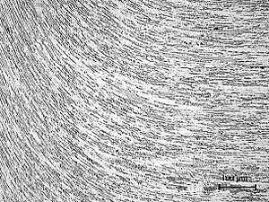

The weld microstructures are essentially divided into four regions, which can be defined as follows, working from the parent material to the bond line:
A: Parent material not visibly affected by the welding process.
B: Area in which the orientation of the elongated parent grains changes progressively from parallel to the bar rolling direction to parallel to the plane of the weld. There is no evidence of recrystallisation in this region, but the formation of equiaxed subgrains in the more severely deformed regions suggest that recovery of the high dislocation density may be occurring.
C: An area where the microstructure consists of fine, equiaxed recrystallised grains, typically <5microns in diameter.
D: An area at the bond line where the microstructure has been dynamically recrystallised, giving a typical grain diameter of 5-8microns.

Typical microstructures from these regions are shown in Figures 3 to 5. It is noted that these structures are typical of those found in friction welds in other iron based ODS alloys [2,4] .

Fig. 4. Microstructure of deformed region in HAZ of friction weld in fine grained Fe 3Al-ODS alloy
