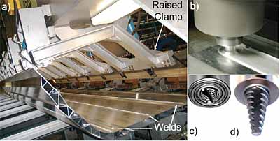

Fig.2.
Fig.2. a) commercial scale FSW machine designed to weld underground train bodies. Workpiece is held by two hydraulic clamps (one is obscured) between which welding head passes from right to left; head has just completed furthermost of three FSWs shown;
b) typical welding head as it is removed from the plate;
c) 25mm shoulder (8mm pin) diameter Triflute MX tool - it is possible to use this tool with zero tilt angle;
d) a 50mm shoulder diameter (50mm pin) Triflat tool designed specifically for welding thicker sections

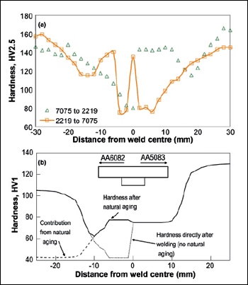

Mixing across dissimilar welds
Friction stir welding has been used with notable success to join dissimilar aluminium alloys in a number of configurations (for references, see the introductory section). It would be reasonable to assume that a process with so much shear strain would result in very effective mixing of the alloys, but experience has shown this is seldom the case. The 'handedness' of the weld is an important factor, i.e. which alloy is placed on the advancing side in a dissimilar combination.[53] Both the heat generation and appearance of the weld cross-section change significantly when the weld handedness is reversed, for the same rotation and traverse speed. Figure 9 shows macrographs of the stir zone in the dissimilar 6082/5083 welds produced using a range of rotation speeds, with AA6082 on the retreating and advancing side respectively. Changing the traverse and rotation speeds can have a significant effect on the flow of material within the stir zone. Generally speaking, the extent of mixing and interface disruption increases as the rotation speed is increased, or the traverse rate is decreased.[53] Unsurprisingly the rotation speed was found to have a significantly greater impact than the traverse speed. For a given combination of weld parameters, the welds produced with AA6082 on the advancing side (Fig.9b) exhibited a significantly lower level of mixing in the stir zone than those with the materials reversed. This is in contrast to the results of Larsson et al.,[49] but corroborates those obtained by Tanaka and Kunagi.[50] Further examples are shown in Fig.10, which shows examples of Al-Mg and Al-Si castings welded to 5xxx and 6xxx series plates respectively. The alternating bands of material originating from the casting and the plate material are clearly seen. It has been suggested that the distance in the welding direction between dissimilar bands corresponds with the pitch distance (the travel speed divided by the tool rotations per second). [137]
Fig.9. Macrographs showing stir zone/TMAZ of 6082/5083 dissimilar welds with a 6082 on retreating side (left side lighter); b) 6082 on advancing side (right side lighter) for welds made at traverse speed of 200 mm min21 and various rotation speeds (dotted lines on 560 rev min21 welds show approximate size and position of 6 mm dia. pin)53 a) AA6082 on retreating side (left side lighter); b) 6082 on advancing side (right side lighter

Fig.33. Hardness traverses across 6mm thickness dissimilar welds:[52] a) 7075-T7351/2219-T6 and 2219/7075; b) 6082-T6/5083-H321[52]
b) 6082-T6/5083-H321 [52]

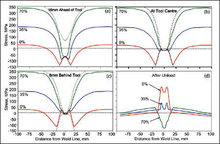

The evolution of longitudinal stress as the tool passes is depicted in Fig.38. It demonstrates that ahead of the tool the compressive stress caused by the expanding hot material impinges on the compressive yield stress locus, causing local plastic straining. Just behind the tool longitudinal tensile stresses begin to generate as the weld material cools. Initially stress development near to the weld line is limited by the low tensile yield stress (Fig.38c). This local tensile plastic straining at the weld line results in the characteristic 'M' shape typically observed in the welded plate (Fig.38d), as the hot region plastically deformed in compression, to a greater width, ahead of the tool becomes stressed in tension as it cools behind the tool. As the tool travels forwards and the temperature falls, the tensile stress level builds up at a rate slower than that at which the yield stress rises so that a point is reached very soon after the tool has passed when no further yielding occurs and the increasing misfit is then accommodated elastically. As the tensile stresses develop near the weld line these are balanced by a compressive stress towards the edges of the plate. Lombard et al.[300] have noted that for AA 5083 the width of the tensile region increases and the maximum tensile stress decreases with increasing heat input. In agreement with experiment,[180, 284,300,301] the residual stress distribution has been found by modelling[294,295] to be dependent on the welding traverse and rotational speeds (Fig.37). Despite the fact that the parametric study is for AA2199,[301] and the modelling is for AA7050,[297] the responses in Fig.37 show a high level of agreement. In both cases the 'M' profile characteristic of FSW shows a small secondary peak centred on the weld line, the peak situated just outside the tool shoulder is slightly higher on the advancing side and the width of the tensile region increases, and the magnitude of the tensile region decreases, as the traverse speed is lowered and the rotation speed is increased. This is believed to be because the high heat input associated with low traverse speeds and high rotation speeds (see Fig.5) leads to more extensive softening in the weld region. This in turn results in overall reduction in magnitude of the longitudinal residual stress, but a wider tensile stress zone (Fig.37). The residual stress field is governed primarily by the as-welded yield strength distribution in the stir zone, HAZ and TMAZ. On the other hand, the natural aging process, while strongly affecting the final weld strength, shows minimal influence on the residual stress. [54, 297]
Fig.38. Effect of external mechanical tensioning (given as percentage of parent plate yield stress) on predicted longitudinal residual stress profiles for AA2024-T6 plate friction stir welded at 770 rev min-1 and 195 mm min-1 (tensile and compressive yield loci are shown as dashed lines)[296] a) as heat source approaches and compressive stresses form; b) directly through tool centre, showing resultant reduction in thermal strain by compressive yielding; c) 8 mm behind centre of pin and at edge of shoulder, as heat source retreats, material begins to cool and tensile yielding occurs; d) final stress state after removal of tensioning loads

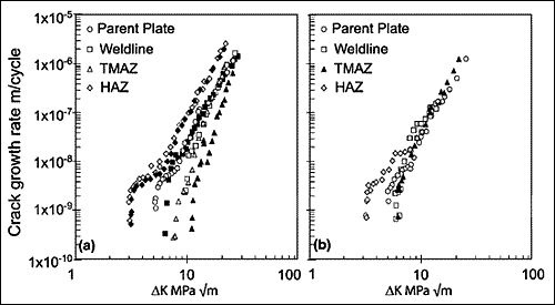

Extensive research has been carried out on 2xxx alloys.[343,346,351-353] For example, Fig.42 compares compact tensile crack propagation tests through welded and parent (TL: transverse-longitudinal section) 2024-T351 material (cracks parallel to the weld direction). The lowest threshold ΔK values were found for cracks propagating in the HAZ, which corresponds to a region of minimum hardness. By contrast, cracks propagating through the weld grew at rates 10 times slower than those of the parent plate. The largest threshold ΔK values corresponded to the TMAZ, which was some 15 times that for the parent plate. All the data appear to converge at large ΔK. To investigate the origin of these differences, the residual stresses were relieved by over 90% by a 2% stretch normal to the weld direction, which was insufficient to appreciably affect the microstructures. The fact that the fatigue crack growth rates for weld line and TMAZ material subsequently coincide with those for the parent plate was taken as evidence that the differences in crack growth rate were primarily due to residual stress. After stretching, the crack growth rate in the HAZ material remains inferior to parent and weld metal, which may be a microstructural effect. For thumbnail cracks growing across the welds, the opposite effect was observed with the slowest rates corresponding to the HAZ and the fastest in the TMAZ. This is consistent with the hypothesis that the residual stresses control fatigue crack growth resistance since the longitudinal stresses in 2024 are normally significantly tensile, with the TMAZ having the largest tensile stresses and the HAZ the compressive or low tensile stresses (see Fig.35). Milan et al.[354] found that under transverse cracking compressive residual stresses increase fatigue resistance in 2024 until the more brittle weld region is reached.
Fig.42. Crack growth data for FSW in 2024-T351 for cracks growing parallel to weld in CT samples:[341] plots are for cracks located at various distances from weld line propagating parallel to weld a) in as-welded condition; b) after 2% stretching (filled and open symbols correspond to different samples)
