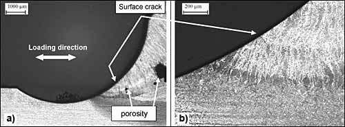

In order to model the fatigue crack initiation process in the toe ground welded joints relevant properties are required for the material where crack initiation took place. Therefore, etched macro-sections of the two specimens from which metallurgical sections transverse to the weld had been prepared, specimens 03 (Figure 5) and 06 (Figure 6), were examined in detail. It was found that both cracks initiated in weld metal, at a similar location within the toe ground groove. The crack lengths were 1.3 and 1.5mm, respectively. From Figure 5a), it will be seen that some porosity was present in the weld metal (arrowed in the figure). The profile of the burr grinding can be appreciated in the two figures (specimen 03 and specimen 06).
Fig.5. Cross-section view of a crack initiated at the ground weld toe of specimen 03. The crack initiated in weld metal and its final surface length was about 1.3mm, crack No. TA-3:
a) At a lower magnification, showing the profile of the ground joint and the embedded flaws,
b) At a higher magnification, showing the initiation of the crack in weld metal
Fig.6. Cross-section view of crack initiation (crack No. TA-1) in the ground weld toe of specimen 06. The crack initiated in weld metal and its final surface length was about 1.5mm: a) Optical micrograph taken at a lower magnification; b) SEM micrograph, showing the initiation of the crack in weld metal; c) SEM micrograph taken at a higher magnification, before micro-hardness measurements were carried out
As both cracks initiated in weld metal and all other cracks that originated from flaws also initiated at a similar location in the grooves, it was tentatively concluded that all cracks associated with flaws initiated in the weld metal. It should be noted that this location did not correspond to the deepest point (mid-section) of the groove (see Figure 5) where there is a greater reduction in the plate thickness and hence where the stress concentration factor (SCF) is highest.[10,16]
The results of the micro-hardness measurements on two cross-sections are given in Table 4. The average hardness (HV) values from the measurements for parent metal, weld metal and HAZ were 177, 210 and 309, respectively. These values were used to estimate the corresponding ultimate tensile strengths of the materials, one of the material properties needed to perform the fatigue crack initiation analysis.
