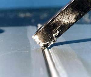

The welding rod should not display signs of degradation (brown spots) or overheating. In the case of PVC, overheating is signified by a shiny smooth surface on the welding rod. In the case of polypropylene, 'splattering' at the edge of the weld indicates overheating of the material during welding. Between each run, as the joint is filled, a chisel or scraper is used to produce a small V preparation for the subsequent adjacent weld runs to be positioned in. This is shown in Fig.5.
Fig.5. Chisel between hot gas weld runs
