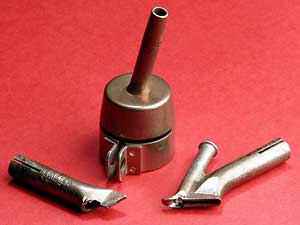

Three nozzle types are most commonly used, the tacking nozzle, the round nozzle and the high-speed nozzle (Fig.4).
Fig.4. Plastic welding nozzles ( left to right) tacking nozzle, round nozzle, high speed nozzle
The tacking nozzle, as the name suggests, is used to tack the materials together before welding. The round nozzle allows the welder to heat the rod and substrate without physical contact with either and is useful for welding in areas with difficult access.
This is less commonly used than the high-speed welding nozzle where the toe of the nozzle contacts the welding rod and allows the welder to put pressure on both the rod and the substrate material whilst welding.
