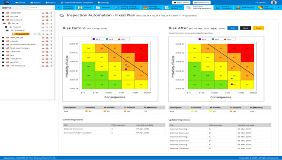

  • Automated Inspection Planning: An automated inspection planning feature has been developed in RiskWISE® 7, enabling inspection schedules to be dynamically generated based on different future planning scenarios

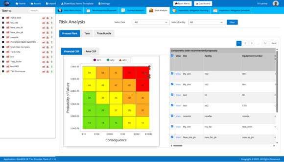

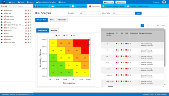

  • Flexible combined RBI assessment, supporting both semi-quantitative and fully quantitative approaches, allowing users to perform assessments based on data availability and project requirements
  • Enhanced automated inspection planning

  • Quantitative RBI assessment as per API RP 581:2016
  • Quantitative RBI module for tube bundles
  • Semi-quantitative assessment as per industry best practice for piping and pressure vessels
  • Semi-quantitative assessment for storage tanks
  • Quantitative RBI assessment for boilers and heat recovery units
