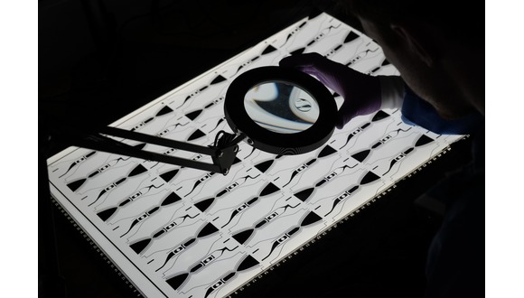

Figure 1. High batch size thruster photomask being inspected
The Innovate UK-funded project saw us carry out a number of small-scale trials to identify a suitable set of diffusion bonding parameters for CuCrZr. Once parameters were identified and validated through characterisation techniques, a final diffusion bonding run was completed, manufacturing a batch of 8 demonstrator thrusters.

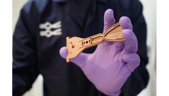

Figure 2. High precision regenerative cooling system enclosed within the thrusters
The bonded thrusters were returned to the client (Second Star) and have subsequently been tested at Second Star’s C-Site facility located at Westcott Venture Park. The thrusters successfully demonstrated stable operation at thermal equilibrium, representing a major technical de-risk of the novel manufacturing methodology. You can see a video of a manufactured thruster during testing at Seconds Star’s facility, below:
