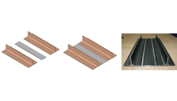

Fully forged integrally stiffened panel developed
(Stretch goal - not originally planned)
Panel reduces number of welds required by 50%

In addition, if FSW were to be implemented using existing SAW gantries, it might be possible to combine SAW and FSW in a hybrid system, making use of the benefits of both systems and delivering a better overall system at relative little extra cost. Such a system might then be employed to manufacture stiffened panels using a technique investigated in the RESURGAM project, replacing the traditional process of arc welding stiffening ribs to plates of steel by a process to butt weld rolled T sections and spacer plates, creating a stronger, fully forged panel with less distortion and only half the number of welds (see figure 1, below).
Figure 1. Novel technique developed for the manufacture of stiffened panels by friction stir welding that allows complex stiffened panels to be manufactured whilst reducing the number of welds required by half when compared to the existing arc welding technique.
