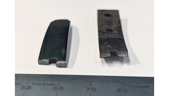

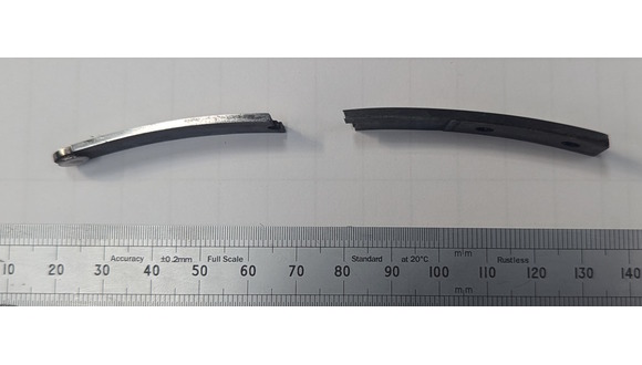

However, as one of the springs broke during a recent manipulation, OASI asked TWI whether a weld repair may be possible. The broken spring had fractured at its centre, in a manner that, with a brief examination, appeared to be a result of fatigue. This is characterised by relatively flat and smooth fracture faces, with a different failure mode (typically brittle or ductile fracture) at the remaining ligament of the face, when the supported stress overpowers the small final area of material.
Figure 2. Broken leaf spring
Figure 3. Fracture faces of leaf spring

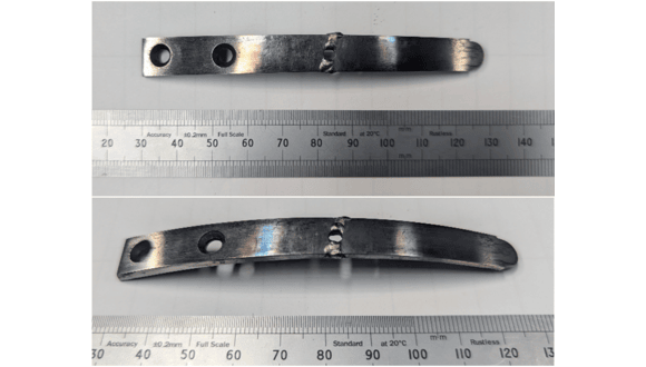

With the assumption that the component was a relatively simple carbon steel, and the low volume of weld metal required, a manual tungsten inert gas (TIG) repair with an ERNiCrMo-3 (alloy 625) filler rod was performed.
ERNiCrMo-3 is a fully austenitic material, which is often used for welding unknown or dissimilar steels due to its ability to support a degree of contamination and also hold hydrogen in solid solution at higher amounts than ferritic materials. This reduces the risk of fabrication hydrogen cracking, which is the primary fabrication welding failure mode in carbon steels. It also provides a good colour match with most steels when polished, which can be important in terms of cosmetic applications.
Figure 4A. Repaired leaf spring
Figure 4B. Repaired leaf spring
The welded part did not show fabrication hydrogen cracking post-weld, and was successfully ground back to its original shape, allowing it to successfully re-used as a spring component.
