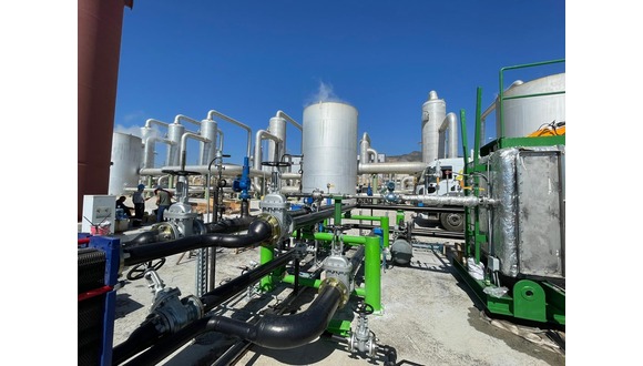

The KZD2 site in Turkey trialled the use of a silica scaling reduction system to control and reduce scale formation before reinjection into the wells.

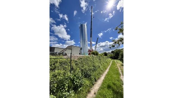

At the other test site, in Insheim in Germany, a tailored energy storage system was installed to provide flexibility. An adiabatic cooling system was sited at the Insheim site to increase the efficiency of the Organic Rankine Cycle on hot summer days using ultra-fogging technology.
