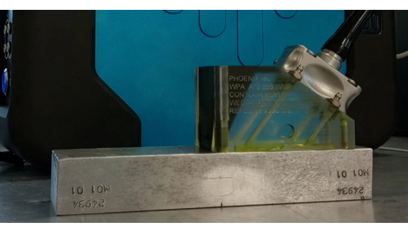

TWI Crystal™ is an advanced ultrasonic inspection software package that, in combination with leading advanced ultrasonic testing equipment suppliers, enables automated full-matrix capture (FMC), virtual source aperture (VSA) and plane wave imaging (PWI) inspection of industrial structures.

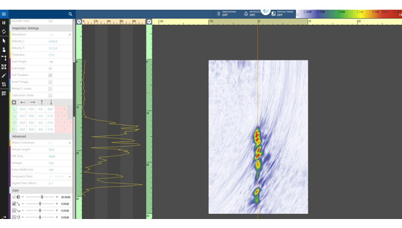

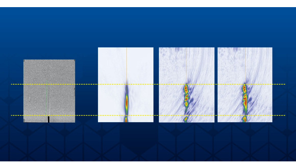

Our latest addition, available as both part of the TWI Crystal Software and the Crystal Software Development Kit packages, is phase coherence inspection capability. This new capability is particularly suited to fatigue crack inspections. Phase coherence imaging enhances the B-scan to more clearly indicate crack-like features, making it easier for the user to diagnose and measure.
