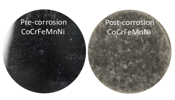

Figure 1. Induction melted equimolar Cantor (CoCrFeMnNi) alloy shown pre- (left) and post-potentiodynamic polarisation corrosion test in H2SO4/HNO3 (pH~2) acidic environment. The alloy has been tested in the initial stages of the project together with other 30 induction melted alloys. Analysis of these corrosion experiments will allow specific alloys to be selected for subsequent high-throughput specimen preparation by means of PVD deposition

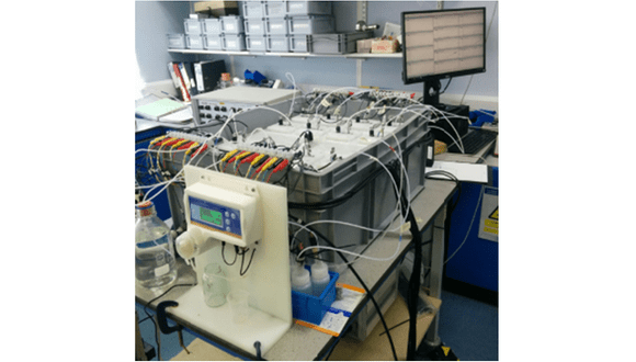

This set of 10 CCAs, together with another 20 CCAs obtained from the development of the other targets in the project (i.e. wear resistance and H2 embrittlement), were then tested by cyclic potentiodynamic polarisation (CPP) in an aerated solution containing a mixture of H2SO4 and HNO3 (corresponding to pH~2), at 25°C (Figure 2). Testing all of the CCAs in the project (i.e. not only the 10 envisaged for the CCUS target), was performed in order to have more data points available to evaluate the correlation between CCA metrics and corrosion performance responses. These CPP tests are currently being analysed to extract corrosion performance metrics relevant for the correlation analysis, such as corrosion potential (Ecorr) and current (icorr), corrosion rate (CR), passivation current (ipass), pitting potential (Epit), etc.
Figure 2. A 16-channel potentiostat is being employed at TWI Ltd. to perform cyclic potentiodynamic polarisation experiments on 30 induction/arc melted CCA compositions
