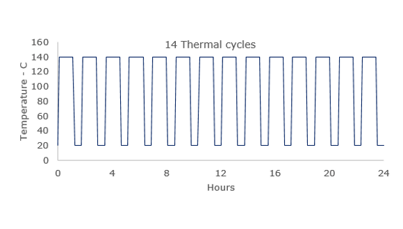

The high temperature validation entailed subjecting the sensors to 14 thermal cycles ranging from 20°C to 140°C resembling extreme operating conditions such as in transportation pipelines in deserts. The test were carried out in a controlled chamber in accordance to the BS EN 60068-2-14: 2009 standard.

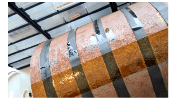

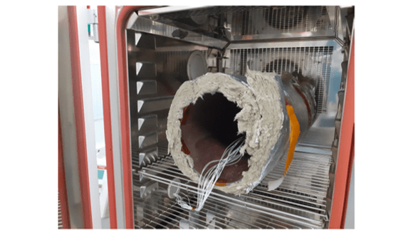

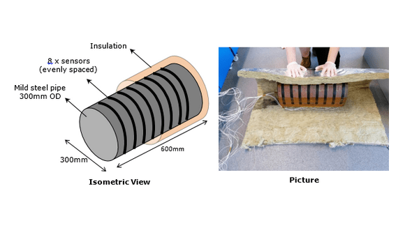

First, the sensors (black stripe) were mounted onto a representative 300mm OD steel pipe including a RockWool insulation layer (as displayed in Figure 1). Then, the test rig was placed inside the controlled chamber (Figure 2) and set to the heat profile shown in Figure 3. The sensors’ electrical resistance was monitored during the thermal exposure with no relevant change in basal resistance. Later, the sensors were exposed to a 1mL droplet of FuelSafe Diesel (Figure 4) and the electrical resistance was measured every second.

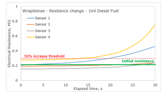

The initial resistance of the sensors was around 200kΩ but, shortly after the 1mL fuel exposure, the sensors’ resistance rapidly increases. The sensor’s response is shown in Figure 5, it can be observed that a 50% increase in resistance, i.e. 300kΩ, is obtained between 10 and 30 seconds from the start of the drop. Therefore, WrapSense is validated for detecting liquid hydrocarbon in less than a minute, and when connected to the IoT box, is capable of sending automatic and customisable alerts via email, smartphone app or SMS text.
