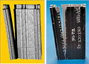

Further insight was developed within the EC project ALJOIN, which studied the crashworthiness of joints in aluminium rail vehicles. Within this project Alcan, Bombardier Transportation, DanStir, NewRail (University of Newcastle) and TWI worked together to develop an understanding of the issues and develop new joint designs and welding procedures, to overcome any inherent joint weakness. This has enabled rolling stock manufacturers to develop new joint designs, suited to the specific fabrication process which will be used. Irrespective of the joining process used, it is important that the rail vehicles have an acceptable level of crashworthiness.
The new designs have been subjected to extensive numerical and physical validations. Computer simulations predict that, with the new designs, overload fracture would occur in the parent material rather than along the weld line. The predictions have been verified by extensive full-scale component tests under high-speed impact at Bombardier's test facility in France ( Fig.1). The newly designed FSW and MIG joints meet the stringent requirements for rail vehicle safety.
Fig.1. Computer simulation and specimen after high speed impact test of a new joint design leading to fracture in the parent material away from the weld

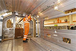

Bombardier Transportation in Derby (United Kingdom) became a member of the very first TWI Group Sponsored Project on friction stir welding. After a three year process review they introduced friction stir welding onto their Electrostar range of vehicles for the UK market. They fabricate an increasing number of car bodies from friction stir welded aluminium panels, which are joined together using MIG welding. The FSW process is used to prefabricate stiff longitudinal extrusions which constitute the carbody sidewalls. No fewer than 376 friction stir welded vehicles have been ordered by London Underground for the latest Victoria Line upgrade ( Fig.3). FSW is likely to be used on future contracts for over 2000 more new trains in the next decade.
Fig.3. Bombardier uses friction stir welded panels for replacement stock for London Underground
