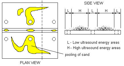

Throughout the welding trials, several notable observations were made. Firstly, in tuning the sonotrode/plate prior to welding, during resonance the sand on the plate was seen to be more active in certain areas. This is illustrated in Fig.2, the sand being seen to 'jump' in the areas between the bolt holes. Next to the holes, and in certain areas on top of the plate, the sand would be relatively inactive; tending to pool. This suggested an uneven distribution of ultrasonic energy across a given plate.

The transverse sections taken along two welds both showed the greatest level refinement to lie in the area indicated by the dashed line in Fig.2. The fact that this area corresponds to a high resonance area (i.e. active region of sand) further suggests that the refinement observed is due to the application of ultrasound energy. The solidification crack observed travelling through the austenite rich areas of the weld, can be attributed to the high restraint imposed on the welded plates, necessary to transfer the ultrasound to the weld pool, coupled with the tight v-joint design.

  3. The increased level of ultrasound energy at the midpoint between bolt holes in a given plate, and lower energy 'dead zones' near the bolt holes.

  • For the apparatus used in this investigation, there is an uneven distribution of ultrasound energy across a clamped resonating plate.
