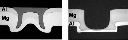

Mechanical fastening
Until recently the only mechanical fastening system for magnesium to other materials has been by bolting. While this method performs well, it is unlikely to be suitable for mass production vehicles for weight, cost and speed considerations. In recent years there has been a great deal of development for aluminium of self-piercing riveting (SPR) and clinching, and it was natural to try to extend these processes to magnesium-aluminium. This has been done with considerable success ( Fig.8); in addition, SPR has been demonstrated for Mg-steel joints.
Fig.8. SPR (left) and clinched (right) joints between aluminium (1mm thick) and magnesium (3mm thick) alloys
The principal difficulty is caused by the poor ambient temperature ductility of magnesium, necessitating heating of at least the magnesium component prior to making the joint. While this is easy under laboratory conditions, the successful industrialisation of the process will require the development of machine tools capable of providing the right temperature conditions in an acceptably short time; it is believed that, by using a highly localised mechanism applied to the magnesium component only, a cycle time of 5s is achievable. This is an important area for further work.
Joint performance - To give an indication of joint performance, Fig.9 illustrates the shear strength of SPR and clinched joints in relation to an M8 steel-bolted joint - a severe comparison. Not surprisingly they are considerably weaker. However, a more useful comparison is against the broken line, which indicates the strength of a comparable resistance spot welded (RSW) joint for aluminium-aluminium: a recognised technique that is regarded as having acceptable properties; in every case the SPR and clinched joints are superior. In the case of tensile loads, SPR joints were found to perform significantly better than clinched joints for a wide range of alloy combinations. All the joints performed considerably better than equivalent RSW joints in aluminium-aluminium. Some hybrid (SPR + adhesive) joints were also tested, and it was interesting to note that, in some cases, these were weaker than the equivalent SPR-only joint; this effect can be attributed to the entrainment of adhesive into the SPR joint, adversely affecting the details of the expansion of the rivet.
Fig.9. Comparison of the shear strength of SPR and clinched joints in comparison with an M8 steel bolted joint. The broken line represents the performance of a comparable RSW in aluminium a) Self-piercing riveted joints

Corrosion - Some corrosion testing has been performed on a number of joints. While the number and nature of the tests mean that sound statistical conclusions would be premature, it is possible to make some tentative remarks:
  • Both the ASTM B117 salt spray test and the GM9450P cyclic salt spray test caused corrosion in the joined components, as would be expected from the materials involved. Most important, in the case of SPR, there was no attack of therivet.
  • The presence of adhesive is beneficial.
  • Clinched joints were generally inferior to SPR joints due to the geometry (causing water to collect) and thinning of the section.
