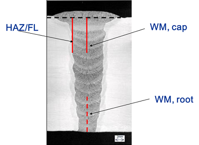

Fracture mechanics SENT testing
The other novel feature associated with strain based analysis concerns the type of specimen used in fracture mechanics testing. Fracture toughness is determined using surface notched, single edge notch tension (SENT) specimens. These have been found to be more representative of pipe fracture behaviour than the more conventional and standardised, deeply notched, single edge bend specimens (SENB). This is because the crack-tip stress-strain field in the specimen (or crack-tip constraint) better replicates that in a circumferential crack in a pipe than does a standard, deeply notched SENB specimen which provides significantly higher crack tip constraint [11]. A consequence is that higher fracture toughness is determined using SENT compared with SENB specimens. Fracture toughness is defined by a J-integral resistance curve, since it is assumed that, for the materials and temperatures involved during installation, upper shelf performance will be achieved and unstable fracture by cleavage (in ferritic steels) will not take place. The geometry of the SENT specimen is shown in Figure 4. Rectangular or square section specimens are permitted and these can be either pin-loaded or clamped using wedge or hydraulic grips, as illustrated. The day-light between the clamps is defined as ten times the specimen width. (The specimen width is similar to the pipe wall thickness). If pin loading is employed, the only practical method of achieving this with the notch orientation employed is to clamp the specimen and then pin load the clamp. The specimen is surface notched and fatigue cracked to a depth ranging between 20 and 50% of the specimen width. Specimens are notched and fatigue precracked to test the weld metal (either from the weld cap or root side) and HAZ as illustrated in Figure 5. A notch from the weld cap side is often used to test the HAZ to minimise problems with missing the target HAZ if the fatigue crack tip is longer than expected. A comparison of the J resistance curve obtained from bend (SENB) and tension (SENT) is shown in Figure 6 indicating the differences that are typically observed.

Pisarski Figure 5
Figure 5. Girth weld showing notch locations
The procedure is intended to be applicable to ductile materials (it is not generally applicable to situations which the SENT specimen fail by cleavage), and to girth welds which have a higher yield strength than the parent pipe (ie overmatch). There is no fundamental reason why results from SENT specimens fracture by cleavage should not be used in an assessment. However, fracture toughness values obtained from such tests would be expected to result in impractically small allowable flaw sizes for high strain applications. Furthermore, there is concern that since cleavage is sensitive to changes in crack-tip constraint, increases in crack-tip constraint in the pipe girth weld due to variations in geometry and/or material could trigger cleavage at lower fracture toughness than that determined in the SENT tests. Results from standard, deeply notched bend specimens (such tests to BS 7448:Part1) are not subjected to such concerns since these are designed to provide high crack-tip constraint which provides lower bound fracture toughness.
