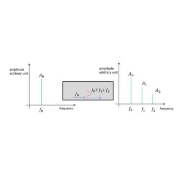

FrictionHarmonics and subsequently the KiScan system adopts a non-linear ultrasonic technique, which has been customised for the inspection of kissing bonds in friction stir welds. The technique uses finite amplitude or acoustic-elasticity to investigate defects in materials. The finite amplitude harmonics measure the acoustic harmonics generated by the interaction of a sound wave with nonlinearities in the material. If finite amplitude ultrasound passes through a region of non-linear properties, it generates higher order acoustic harmonics signals. The harmonic of the fundamental wave is generated when the mechanical wave interacts with an imperfect interface. Since kissing bonds are very tight defects they lead to ‘clapping and rubbing’ when they are excited by the input signal. This generates higher harmonics of the input signal. You can see a schematic of the behaviour of the input pulse after interaction with a kissing bond defect in Figure 1.

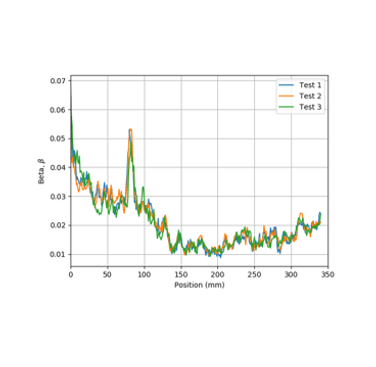

The NLUT scanner has been operational for over 18 months, which has allowed for new hardware and software to be commissioned to ensure robustness ahead of environmental testing. Environmental testing was carried out the friction stir welding facility at TWI Yorkshire to determine how the scanner performed in an industrial environment. The detection system has successfully demonstrated good accuracy and repeatability (see Figure 2) and now achieved TRL7 (Technology readiness level). (see Figure 2).
