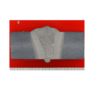

The limited number of welding trials and tests carried out in this experimental programme demonstrated the capability of the D-Arc® process to produce full penetration single pass welds on 20mm thick butt joints with backing. The produced welds were without any significant spatter or distortion. The accuracy of the joint preparation and the fit-up of the plates onto the backing support was found to be critical in obtaining a consistent joint. Limited fillet welding trials in the flat welding position showed that fillet welds of up to 20mm throat thickness could be produced in a single pass with the D-Arc® process, although susceptibility to centreline cracking was observed under certain welding conditions.
Charpy impact testing did not show any major reduction in toughness of coarse grained HAZ on S355J2 or S460N steel plates.  Acceptable weld metal toughness also could be achieved with appropriate welding consumables. A hardness survey of the welds did not indicate any abnormal effect of welding on the weld metal or the HAZ hardness.

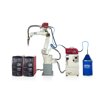

Figure 1. General Configuration of the D-Arc® welding set-up (Ref: DAIHEN Corporation WST-0021E1.7)
Figure 2. Transverse section photomacrograph of a typical butt weld on 20mm plate
