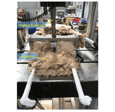

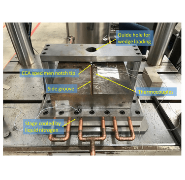

Jessica completed her PhD work by carrying out larger scale compact crack arrest tests for one of the steels (the EH 47 shipbuilding steel, which showed the largest difference between the two KIa curves), in order to measure the crack arrest toughness directly from the tests, according to methods given in ASTM E1221, and compare the results against the empirical predictions. Each compact crack arrest (CCA) specimen was over 300mm square and 80mm thick. The initiation of a brittle crack was done via the application of a wedge load into a hole at one end of the specimen, which loads a slit cut into a low toughness weld bead at the base of the specimen starter notch. The wedge load is applied and then removed through several increasing load cycles until a brittle crack occurs. Side-grooves are machined to direct the brittle crack in a planar direction through the specimen. Each test was done at a given temperature, cooled using a liquid-nitrogen cooled stage and insulated throughout the test. The experimental set-up is shown in Figures 1 and 2.

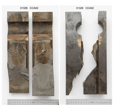

After the test, the specimen was heat-tinted and then broken open to reveal the length of the arrested crack, from which the arrest toughness KIa could be determined. An example is shown in Figure 3.

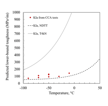

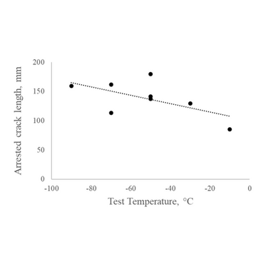

Larger scale crack arrest tests requiring a running brittle crack to arrest within the ligament of the test specimen are notoriously challenging, subject to scatter, and sometimes unpredictable. However, of the eight CCA tests carried out on this steel, all successfully managed to arrest a brittle crack, and allowed a value of KIa to be determined, for test temperatures between -10°C and -90°C, Figure 4. The values of KIa calculated using the ASTM E1221 method were plotted against temperature, and compared to the empirical predictions based on NDTT [2] and T4kN [3], shown in Figure 5. The results were consistently close to, but above the curve based on NDTT predictions, but the results were over-estimated by the T4kN prediction.
Figure 1. Setting up the compact crack arrest specimens
Figure 2. The CCA specimen cooled and under test
Figure 3. Fracture appearance of one of the CCA specimens after test and heat-tinting of the arrested brittle crack
Figure 4. Arrested crack length plotted against CCA test temperature
Figure 5. Comparison of the CCA KIa results, with predictions of arrest toughness based on small-scale tests

The work here confirms that lab-scale crack arrest testing to determine the arrest toughness, KIa, can be done, as shown by the successful tests performed at TWI. For applications where small-scale testing is used to estimate crack arrest behaviour, Pellini testing to determine NDTT, and estimations of KIa based on that, appear to provide a conservative prediction of the behaviour expected from compact crack arrest testing.
