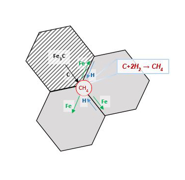

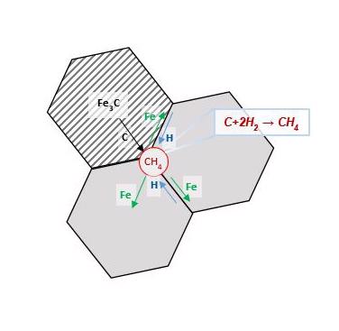

Figure 1a. Schematic illustration of diffusion and reaction processes taking place in HTHA

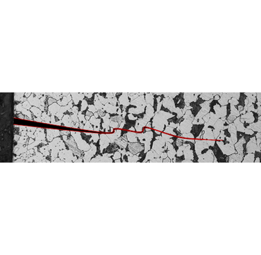

Figure 1b. Micrograph of degraded C-Mn steel due to HTHA
Figure 2. Schematic showing crack development due to HTHA ahead of general attack at the surface
