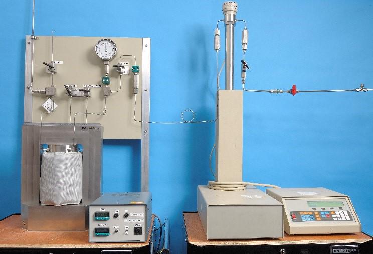

TWI has designed, built and commissioned a 500bar test facility (Figure 1) which was used for testing of the corrosion performance of carbon steel welds in 500bar CO2 to simulate high-pressure (HP) oil and gas wells.

To address the current lack of data on HP CO2 testing, TWI’s CO2 test facility was used to assess carbon steel welds at 40°C in a de-aerated 3.5wt% NaCl solution which was purged with 500bar CO2for 30 days.

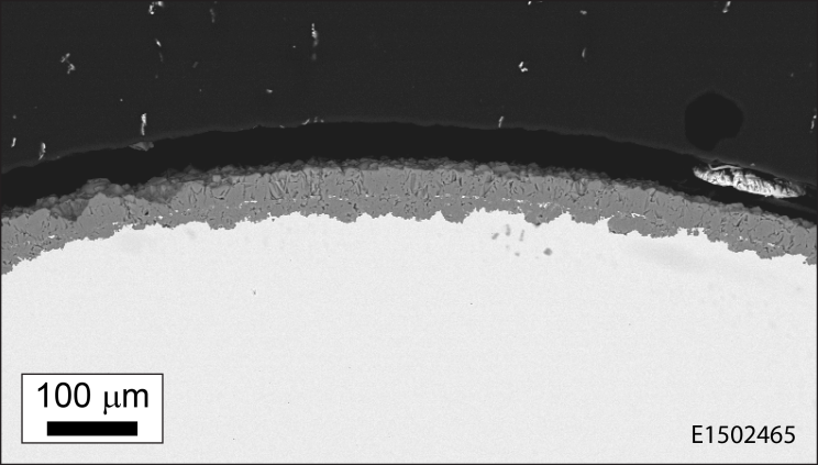

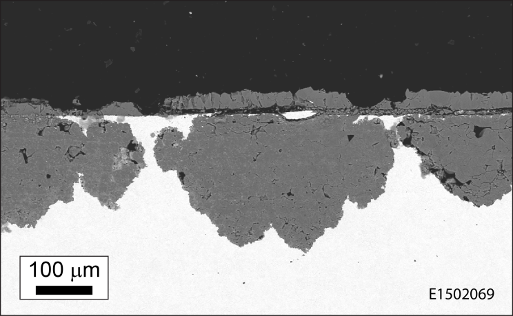

Examination of cross-section revealed that the specimen was covered with a 20-40µm thick carbonate scale. This scale was identified as siderite, an iron (II) carbonate mineral, by XRD. Some areas also showed a number of large pits of 300-500µm width (Figure 2).
Testing carried out under lower pressure, gaseous CO2 in a similar NaCl solution caused more general corrosion and scaling (Figure 3).

Figure 1: 500bar test facility
Figure 2: Micrograph of the cross-section after testing at 500bar
Figure 3: Micrograph of the cross-section after testing at 10bar
