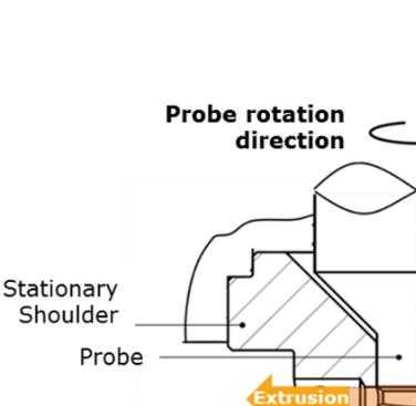

TWI has recently invented and patented a new stationary shoulder variant of FSC (SSFSC) which has proven to overcome many of the drawbacks of conventional FSC. As shown the figure, a stationary shoulder is employed to confine the nugget of viscoplastic material, limiting the flow of material extracted by the probe. With the appropriate rotation direction, the geometrical features of the probe cause part of the nugget material to be conveyed into the shoulder. The material extracted is then re-directed towards a series of vents in the shoulder and expelled.
As the tool assembly traverses along a pre-defined path, the process of extracting the material leads to the formation of i) a closed channel within the workpiece and ii) the production of extruded wire. Process parameters and tool designs are combined such that the rate of material extraction per unit distance is limited to maintain a fully consolidated channel ceiling.

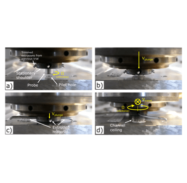

The cycle is initiated by plunging the rotating probe into the plate. Once the probe reaches its target plunge depth, the machine initiates its traverse motion. As the tool traverses along the workpiece, the plasticised material is conveyed upwards by the rotating probe threads, into the shoulder and then expelled as extruded material. This subtraction of material leads to the formation of a closed sub-surface channel.

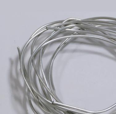

It is interesting to note that the material extruded from the plate in the form of wire could be used as feedstock for other processes, like wire-based additive manufacturing, or could be used simply as welding wire. CoreFlow®, indeed, is capable of extruding an unlimited length of wire from a plate or a pipe.
This process, labelled ForgeWire, is of great interest for producing spool of wire from materials with poor extrudability, such as alloys of aluminium or magnesium. Wire manufacturers or additive manufacturing process developers now have a quick option for producing wire with a tailored chemical composition and from experimental alloy formulations (e.g. Aluminium-Lithium or Aluminium-Scandium), potentially even directly from rolled product or cast billets.

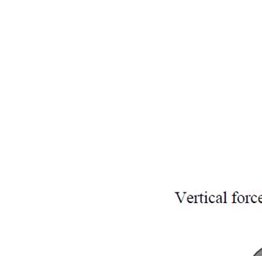

Figure 2. CoreFlow® tooling description and main process parameters
Figure 3. Main stages of the CoreFlow® cycle: (a) Start of probe spindle rotation; (b) Plunge into workpiece; (c) Probe is engaged with the workpiece and shoulder contacts the workpiece surface which initiates material extrusion; (d) Tool traverses along a defined path to form a sub-surface channel with consolidated channel ceiling, extruding material as it travels
Figure 4. Spool of wire extruded as by-product of CoreFlow®
