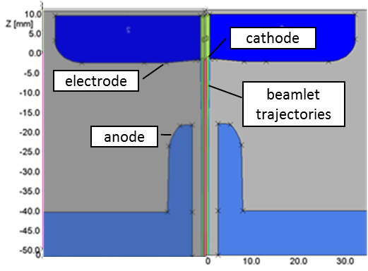

Figure 1: Example of a 2D solution of an electron gun showing the geometry in cross section and the electron beamlet trajectories.

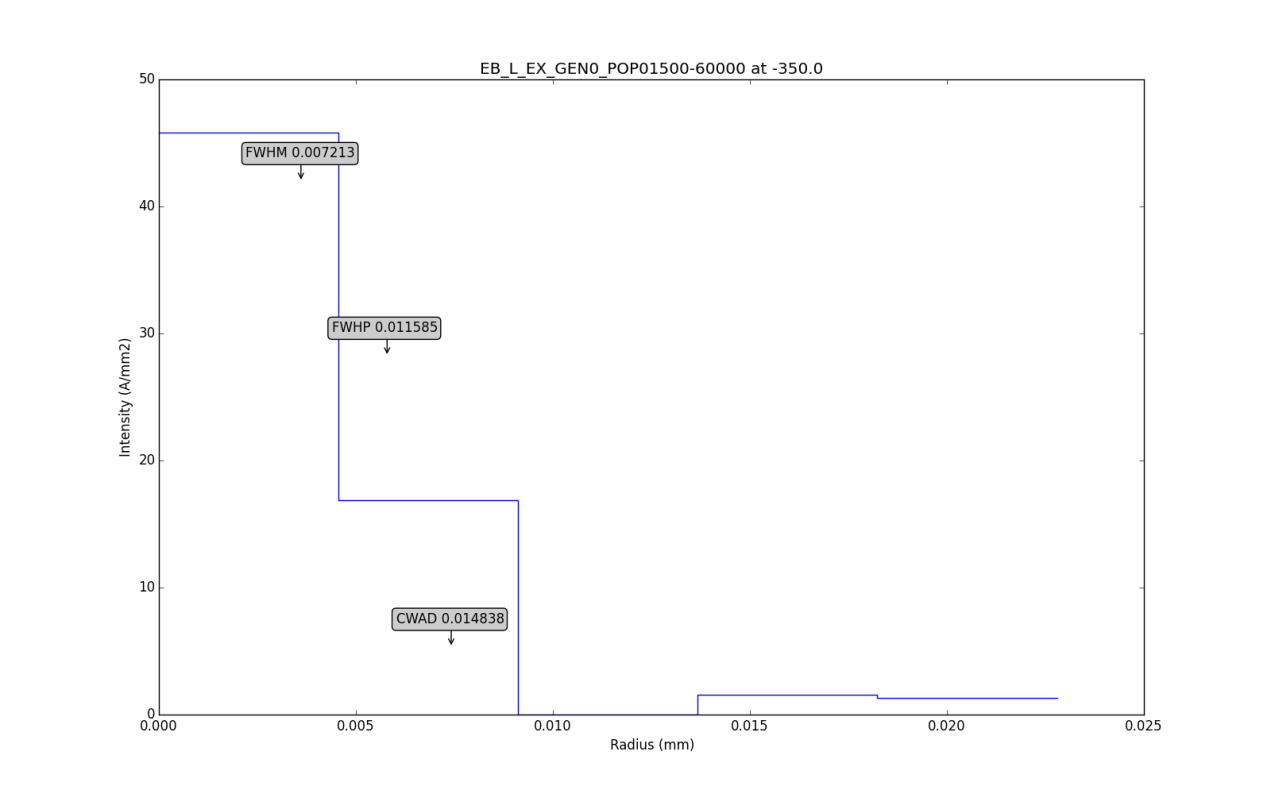

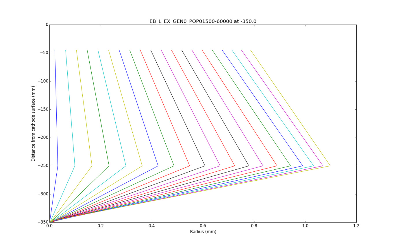

Consequently, a number of beam metrics were derived from the trajectory files, which could then be used subsequently as a measure of the gun design fitness in order to enable selection of better designs within a population as part of a design evolutionary algorithm.
Figure 2(a): Example of a ray diagram after projection of trajectories from the gun model through a mathematical lens to their focus at the work piece.
Figure 2(b): Example of a beam intensity plot after projection of trajectories from the gun model through a mathematical lens to their focus at the work piece

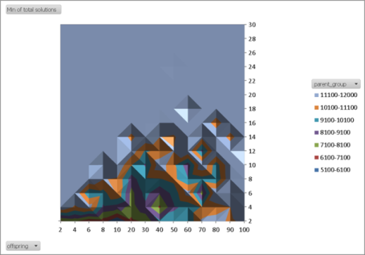

The objective of this trial was to determine the most efficient settings of the evolutionary parameters for solving a shape fitting optimisation. This has been carried out for 3, 5, 8 and 10 cornered shapes. For 13 cornered shapes, the individual optimisations were taking too long to allow practical trials over a wide range of evolutionary parameters. Efficiency was measured by recording the total number of calls to the scoring function for each optimisation – this must be done for the initial parent group and each generation of offspring. In the analogous electron gun design optimisation, a call to the scoring function would require a model solution and trajectory analysis, taking up to 1 minute. In this case, a call to the scoring function took under 1msec, allowing a large number of trials to be carried out.
For the 3 to 10 cornered shapes, the number of offspring has been varied from 2 to 100, the parent group from 2 to 30, the mutation scale from 0.05 to 1 (5% to 100%) and the mutation rate from 0.01 to 0.1 (1% to 10%). In total, the different combination of parameters led to 42,000 optimisations being executed for each shape. Each optimisation required from 338 (fastest 3 cornered) to over 200,000 calls (slowest 10 cornered) to the scoring function.
The results were analysed by plotting the number of calls as a function of the number of offspring and number in the parent group, see figure 3(a) and the mutation rate and mutation scale, see figure 3(b), both for 10 cornered shape evolution. Also, sampling was carried out of the most efficient 1% of optimisations for each shape and the modal evolutionary parameter settings were extracted – see figures 4(a) and (b).
Figure 3(a): The number of score function calls as a function of the parent group and offspring group sizes.

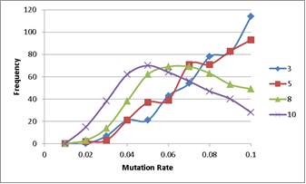

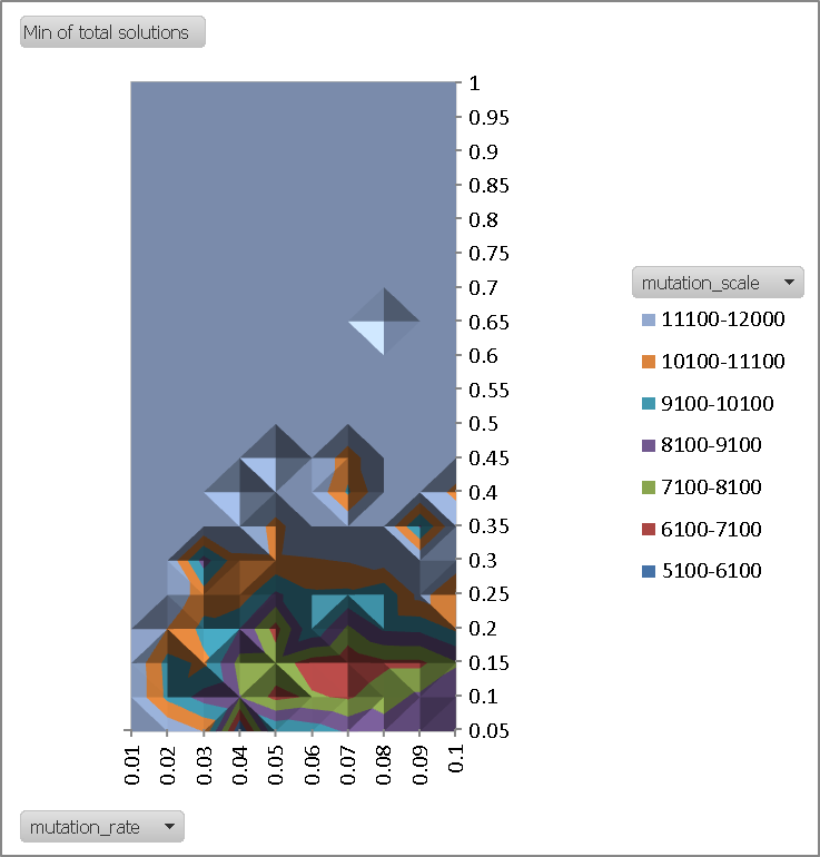

The  results show that a small parent group of 2 or 4 is most efficient over all the range of shapes. It is also clear that as the number of corners increases the optimum values for mutation rate decreases. For 3 and 5 cornered shapes the optimum mutation scale is 0.15 dropping to 0.1 for 8 and 10 cornered shapes. For 3 cornered shapes the optimum mutation rate is 0.1, decreasing to 0.06 for 8 cornered shapes and 0.05 for 10 cornered shapes. This is shown in figures 4(a) and (b).

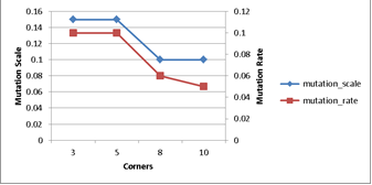

Figure 3(b): The number of score function calls as a function of the mutation scale and mutation rate
Figure 4(a): Histogram of the top 1% optimisations showing decreasing mutation rate with increasing problem complexity
Figure 4(b): Modal values of mutation scale and mutation rate of the top 1% efficient optimisations
In summary, this trial has shown that as problem complexity increases the optimum mutation rate and scale for rapid optimisation will be lower. It indicates that values of mutation rate and scale should be used of less than 0.05 and 0.1 respectively. Regardless of problem complexity, parent groups of 2 or 4 are the most efficient, as are offspring numbers of 10 or less.

The electron gun evolutionary design process was applied to a novel radio frequency (RF) excited plasma cathode gun design (del Pozo et al. 2014; Ribton & Sanderson 2012). This type of gun design is a diode having a high-voltage electrode and cathode at the same potential. The cathode is a plasma, but for simulation purposes the cathode surface has been modelled as a lanthanum hexaboride thermionic emitter over a range of temperatures and therefore emissivities, producing electrons with no thermal energy.
The gun design was required to produce an intense electron beam at focus, therefore of high brightness, and produce a reasonably low angle beam so that it could pass through an existing gun column with a constriction at the electron lens. However, too low an angle beam would give poor electron optic magnification so an optimum beam diameter of 4mm at the lens position (150mm from the cathode) was chosen. These requirements are summarised in Table 2.

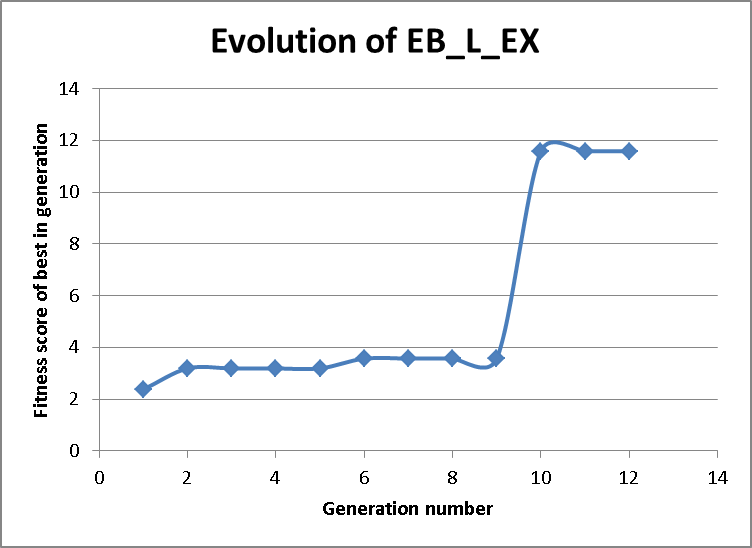

The progress of the automatic design algorithm was monitored through the plotting the best fitness score of each generation. This is presented in Fig 5.
Figure 5: The best fitness score in successive generations
The use of an evolutionary algorithm for the electrode optimisation allowed designs meeting the requirements to be found within 2 to 3 hours of computing time without human expert intervention. This compares well with normal trial and error design requiring frequent expert intervention over a period of 10 to 15 hours. The ability to template constrained parts of the design was useful in ensuring that the algorithm only explored mechanically viable designs making it more efficient. Further comparison with other optimisation methods will be carried out in the future as details of solution times for electron gun optimisation methods are not published at this time
