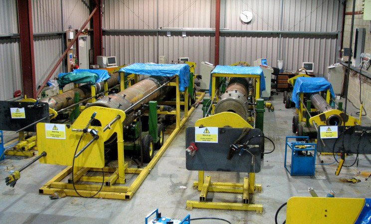

The resonant frequency of a test specimen depends on the specimen’s mass and stiffness, and therefore the outer diameter and wall thickness of the pipe being tested. Specimen lengths are chosen so that they have a resonant frequency of around 30Hz. At this frequency, approximately 2.5million cycles are applied to the test specimen in each 24 hour period. TWI’s resonance test machines can accommodate pipes in the range 8in to 36in outer diameter. Typically, 8in outer diameter specimens are around 4.5m long and 36in outer diameter specimens are around 10.5m long (Figure 3).
Figure 3 Four of TWI’s resonance fatigue test machines, capable of testing pipes with diameters ranging from 8in to 24in.
Figure 3 Four of TWI's resonance fatigue test machines, capable of testing pipes with diameters ranging from 8in to 24in

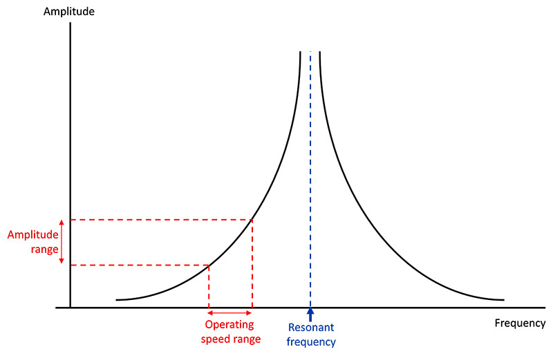

Tests are run below the resonant frequency so that the applied stress range can be carefully controlled (Figure 4). By altering the speed of rotation of the excitation force (which in practice is achieved by altering the motor speed), the deflection and therefore strain range can be controlled.
Figure 4 Resonant response showing how the specimen deflection is controlled by altering the speed of rotation of the excitation force.
