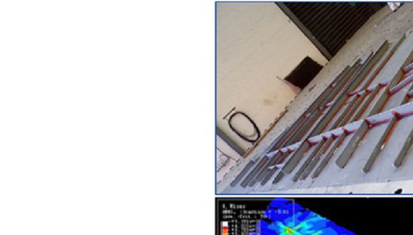

Firstly, Huan gave a talk for the online 2022 International Conference on Welding Materials and Technology, which was hosted by the Metallurgical Corporation of China, from 23-29 May 2022. The talk was on, ‘The Modelling of Manufacturing Processes,’ and detailed how manufacturing process simulations translate joining technologies and manufacturing processes into mathematical models to understand the relationships between processing conditions, heat transfer, stress development, deformation, and phase transformation. Understanding the effect of and optimising processing conditions (current, voltage, heating rates, soak times, weld sequence, etc) can be costly and time-consuming during the design stage, especially when only a trial-and-error experimental approach is available.

Weld sequence optimisation of a ship panel to control distortion.
