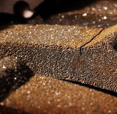

Corrosion Modelling
Corrosion is a dangerous and costly problem which can compromise structural integrity. The annual worldwide cost of metallic corrosion is estimated to be over $2 trillion yet experts believe that 25-30% of this could be prevented by proper corrosion planning and engineering.
TWI has experience in modelling corrosion and corrosion protection techniques in both aqueous and atmospheric environments. The chemistry of corrosion can be considered as an electrochemical phenomenon, whereby oxidation occurs at an anodic site, causing electrons to travel to a cathodic site, where reduction occurs.
To aid in corrosion protection, TWI models cathodic protection in subsea structures to determine the level of protection and the corrosion rate of the structure and sacrificial anodes. The effects of different coatings and paint on corrosion rate can be evaluated to find the most suitable solution for a given environment.

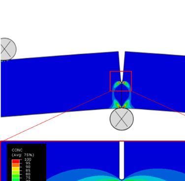

Simulation of Hydrogen Embrittlement
Hydrogen embrittlement occurs when metals become brittle as a result of the diffusion of hydrogen into the material. Hydrogen embrittlement can lead to failures, even when loads are small, due to the presence of welding residual stresses, a strong hydrogen presence, and undesirable microstructures.
However, multiphysics modelling can predict the diffusion of hydrogen in metals and its effect on mechanical properties. TWI have state-of-the-art capabilities that couple hydrogen diffusion models with fracture mechanics principles to assess the risk of hydrogen-induced cracking. TWI’s unique and world-class corrosion and environmental testing labs enable accurate calibration and validation of the modelling methods.

[1] https://www.twi-global.com/what-we-do/research-and-technology/research-reports/industrial-member-reports/fracture-of-pipeline-steel-in-a-sour-environment-at-ambient-temperature-1132-2020
Hydrogen concentration prediction at a crack tip [1]
