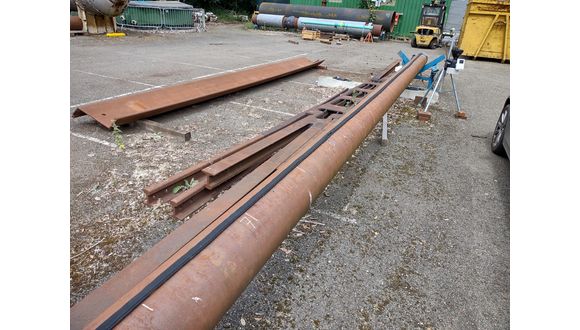

The 6-month large-scale environmental tests for the WrapSense Project have concluded. The testing involved the installation of the WrapSenseLD technology in a representative steel pipe, which was exposed to 6 months of winter weather. This was in order to validate sensor performance under environmental loading and correlate slight sensor disturbances to the relevant weather information.

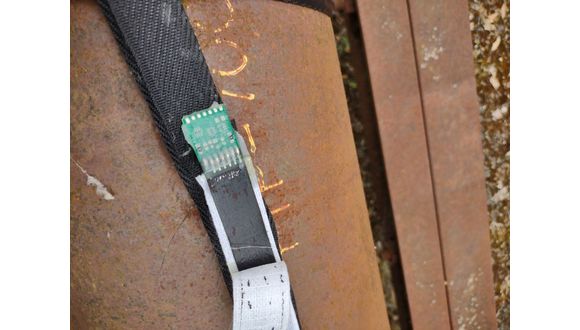

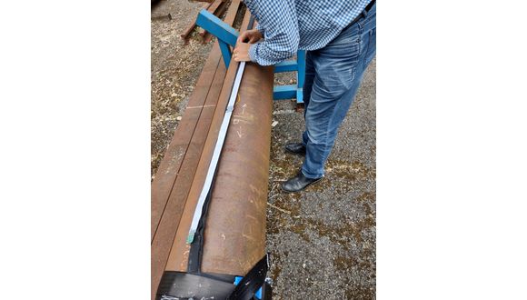

Ten 1-metre long sensors were installed on a 10-metre long, 300mm OD steel pipe. These sensors were connected to an Internet of Things controller unit to provide the data transmission from the sensors and report readings hourly. In addition, a wireless weather station was set up next to the WrapSenseLD to assess weather conditions and any environmental damage to the sensor readings.
No false alarms were registered during the test and the system remained stable throughout. In addition the 3-month weather testing was also completed successfully, demonstrating correlations with temperature and humidity.
