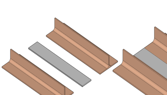

  • An alternative technique for the construction of stiffened panels, using rolled steel sections spaced by steel plate, generating an all forged, low distortion, high strength panel that can easily incorporate different thicknesses and grades of steel to tailor its properties to the envisaged structural loading case;

Stiffened panels concept.
