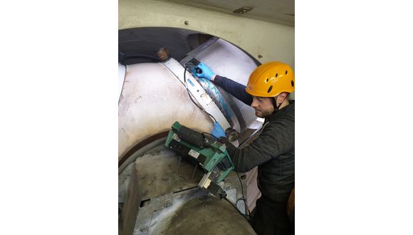

TWI completed PAUT inspections of the blade roots for all blades, reporting on any cracks within the blade roots and detailing the circumferential length of each crack, as well as the cumulative length of cracks within each blade root.
The key objective was to collect and analyse the PAUT data and to measure any crack indications in the bolt hole regions, which was achieved by:
  • Using the PAUT system to detect and measure crack dimensions
  • Scanning the probe and positional encoder around the ring on the accessible external surface, in 500mm sections
  • Recording PAUT data around the ring circumference
TWI produced a report for the client that compared the most recent results with results from previously completed inspections, highlighting any changes in circumferential crack lengths.

Figure 1. Performing PAUT scans on the wind turbine blade root
