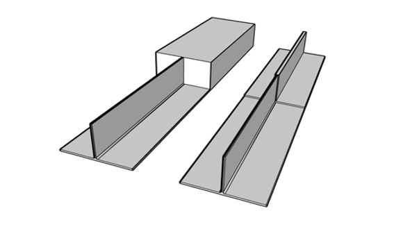

Building on this work, TWI has recently achieved another important step and successfully developed the welding process for joining two thick section (>10mm) Ti-6Al-4V plates to produce a T-joint as a near net shape technique, as shown in Figure 1. This technique saves material and reduces machining times. It is estimated that the material saving could be more than 90%, while reducing traditional machining eliminates more than two-thirds of the production costs for some components.

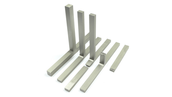

After the joint was welded using SS-FSW, specimens were extracted and assessed for tensile strength of the base and the leg plates. Both tests failed in the parent material outside the weld nugget, with ultimate tensile strengths of over 960MPa. The specimens are shown in Figure 2.

Figure 1. Illustration of titanium T-joint machined from a solid block (left) or machined from a near net shape component fabricated from base and leg plates using SS-FSW (right)
Figure 2.	SS-FSW Titanium T-joint, the specimens from left to right: 1) Welded, 2) Machined to shape, 3) Tensile failure location on the base plate and 4) Tensile failure location on the leg plate, showing both failures in the parent material
