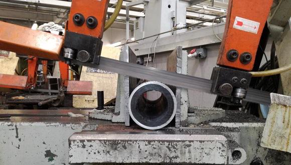

Polymer lined pipe cutting at TWI

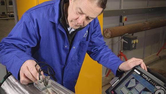

Cladview for mechanically-lined pipes
