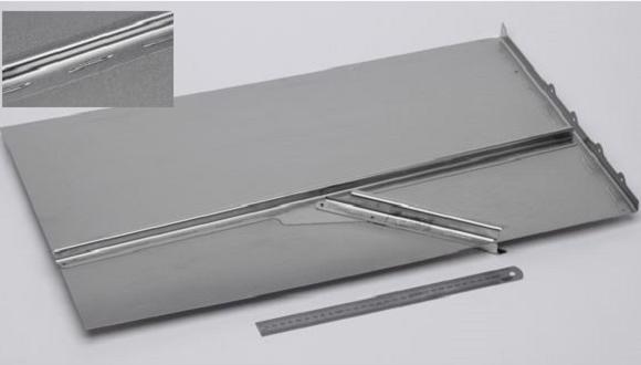

  • Firewalls and bulkheads: These structures are currently made out of overlapping sheets and stiffeners, riveted together. OLIVER has demonstrated the successful replacement of rivets by laser stake stitch welds, a net weight reduction then being possible. Coupon-level testing also indicates that the static and dynamic performance of such a structure can be maintained, or even bettered, when compared with riveting. Additionally, cost modelling suggests that manufacturing complexity can be reduced, with fewer processing steps, and thus the economics of that manufacture improved

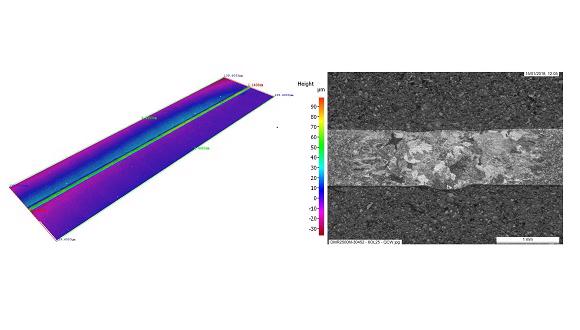

  • Wing leading edge structures: These are also made from sheets. Nevertheless, the maximum width of sheet available from manufacturers is limited which, in turn, limits the maximum length of leading edge structure that can be produced. The OLIVER project has developed laser butt welding procedures, with high quality weld profiles which, with minimal additional processing, are then suitable for air flow surfaces

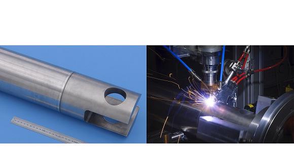

  • Struts: One production route for these involves machining from solid, with its inherently low – and uneconomic – buy-to-fly ratio. Near net-shape manufacturing and assembly methods are therefore very attractive. OLIVER has demonstrated that this can be achieved through the use of laser welded assemblies. Furthermore, the low heat input of laser welding has facilitated the incorporation of carbon-fibre reinforced Ti-MMCs to such assemblies. The consequent use of these high specific strength materials has been demonstrated to lead to weight savings

  • Laser stake welding procedures have been developed and demonstrated for both stitch and seam welding, through stacks of up to four overlapping Ti alloy sheets and/or stiffener flanges. Work on coupons and on sub-assemblies representative of firewalls and bulkheads indicates an overall mechanical performance better than with riveted structures, with a simpler, less labour-intensive manufacturing route
  • High quality thin sheet laser butt welding has also been developed which, in the future, can be used to facilitate the production of larger sheets, for longer leading edge structures, whilst at the same time not compromising air flow over the surfaces of those structures.
  • In thicker materials, laser butt welding has also been shown to be a means of assembling multi-material structures, as exemplified by the Ti/Ti-MMC struts targeted by this project. This manufacturing route can be used to improve buy-to-fly ratios, reduce material waste and its associated costs, whilst at the same time facilitating the introduction of novel materials to help bring down weight and increase performance
Laser stitch welded firewall demonstration with (inset) details of the welds made
Low profile laser butt weld between thin sheets: cross-section (right) and laser surface scan (left)
Laser butt welding of a clevis end on to a Ti-MMC tube (right) and the resulting assembly (left)
