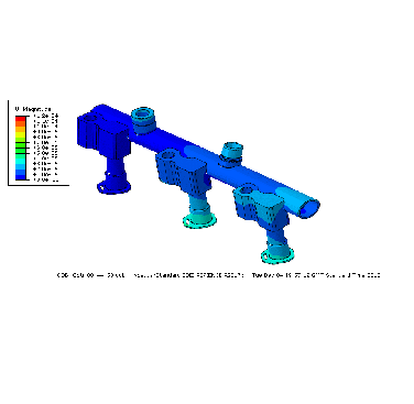

Figure 1a. Finite element model (FEM) distortion predictions for alternative weld sequences

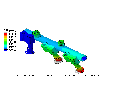

Figure 1b. Finite element model (FEM) distortion predictions for alternative weld sequences

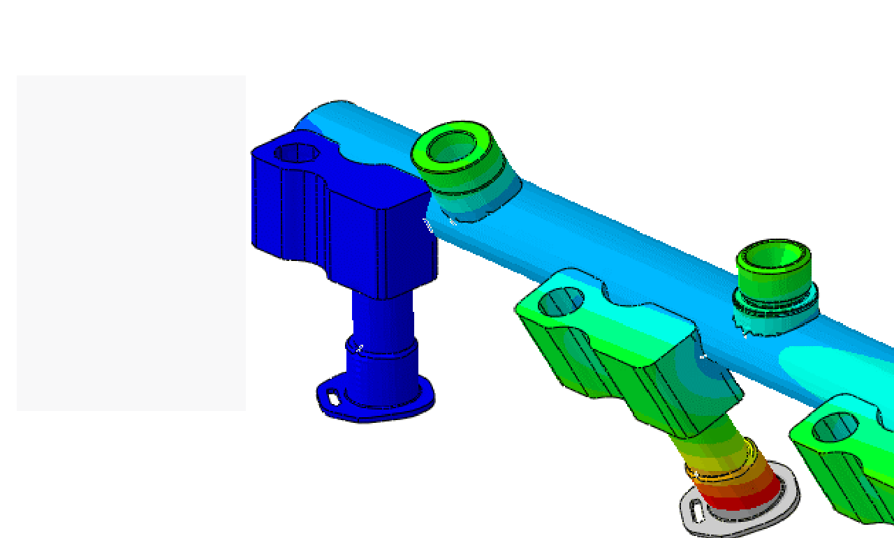

A finite element model was developed, using weld techniques established within TWI, which simulates each of the 22 tack welds in sequence and predicts the resulting distortion.  Figure 1 shows the typical distortion of the weld assembly that can arise due to different tack weld sequences.

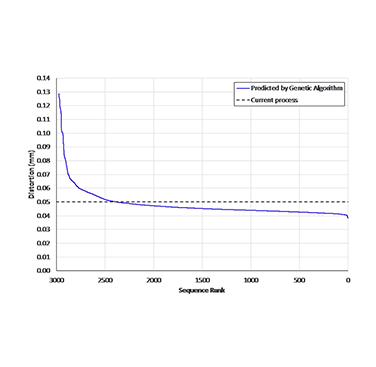

The graph in Figure 2 summarises the predicted distortion for almost 3000 simulations (49 generations of the GA).  The prediction for the current process is shown as a dashed line.
The results show that there are a small number of weld sequences which cause comparatively large distortions.  However the GA routine identifies a number of possible weld sequences that can improve and minimise the distortion compared to the existing manufacturing sequence.  As a result, current work is now being experimentally validated as part of the Optipress project.

Figure 2. Predicted distortion for all sequences
