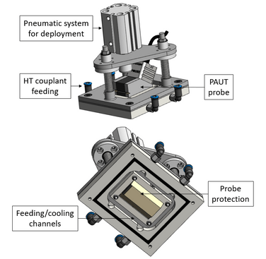

  • Investigate the possibility of using ultrasonic testing (UT) techniques to monitor the emergence of potential flaws in thick-section joints being created using RPEBW systems
  • Design a prototype UT system for real-time monitoring of RPEBW in process conditions
Solution
A review of potential UT techniques was undertaken including: time-of-flight diffraction (TOFD); full matrix capture/total focussing method (FMC/TFM); electro-magnetic acoustic transducer (EMAT); and PAUT. The last was chosen because (1) no magnetism, which is not agreeable to EBW, is involved, (2) the data volume is manageable in comparison to FMC/TFM, and (3) it provided options to correct for any image distortions.
The first task was to simulate the transient temperature profiles in the component during a welding event. This was done using finite element modelling.  Ultrasonic simulation of the beam propagation in the component, when the metal temperature was ambient and when it was elevated, was utilised to establish the level of any distortion in the imaging, and compared with the experiment. Based on this, a prototype system was designed (see Figure 1), which has since been used in a project for EBW monitoring and is currently being considered for arc welding monitoring.
Conclusion
On completion, the project demonstrated that it is possible to undertake online monitoring of EBW, as the temperature levels it requires, using PAUT. Follow-on work then verified the efficacy of the approach for industrial use.
Figure 1. Prototype designed for EBW monitoring tool
