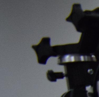

The tracking system consists of four infrared cameras to independently track the probes and samples. Their relative position is used to extract the right signal. So, it does not matter if the sample has been moved during a live scan, as is the case with a real-life scan.
