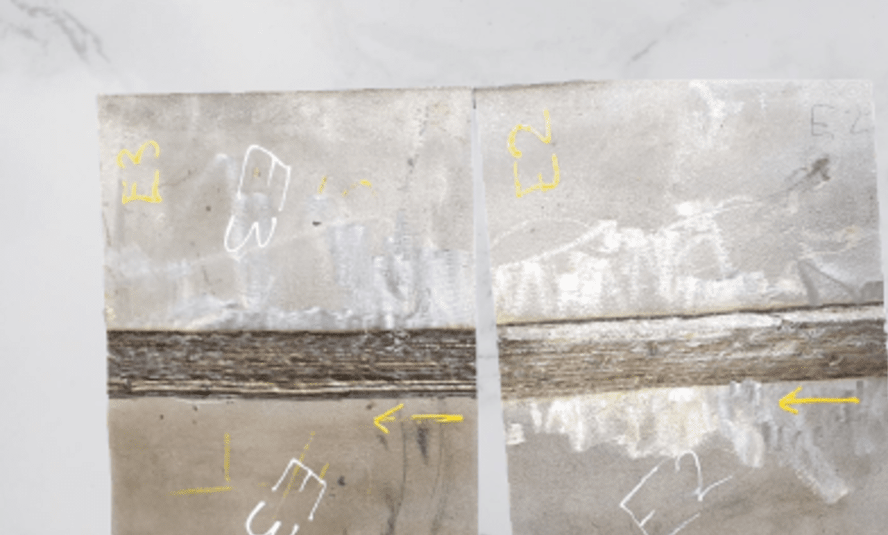

Eighteen representative calibration and welded specimens were fabricated with a variety of differences in material (316L, 304L), welding process (MMA, NGT) and position, namely vertical upwards (PA), downhand (PF) and vertical/horizontal (PC). Defects were introduced within the weld, representing foreseeable defects that could occur during fabrication.
A methodology was established to allow consistent signal-to-noise (SNR) analysis and ultrasonic beam analysis. Each weld specimen went through an extensive set of experiments, including a through transmission hydrophone setup, which allowed for the mapping of the ultrasonic beam after transmission through the weld. Figure 1 shows the setup used to undertake the fingerprint of the welded specimens. Figure 2 shows an example of the ultrasonic beams recorded after transmission through the weld at different sound frequencies.
The defect specimens were then inspected using phased array ultrasonic testing (PAUT) and total focusing method (TFM) techniques using commercially available equipment.  The scans made use of dual matrix array (DMA) PAUT probes.  The DMA probes have no roof angle, so beam steering was achieved via delay laws in the passive axis.  This provided flexibility for the crossing, i.e. focal, point of the transmit and receive beams.  In additional, plane wave imaging (PWI) scans were performed using the 5L64 probe with L-wave transmission.

A methodology was established to characterise the austenitic welds with regards to noise analysis, through transmission beamplot generation and defect inspection in representative specimens. The beamplot analysis showed that ultrasonic beam at the recommended low frequency still presents beam splitting where the major part of the ultrasonic energy propagates downwards towards the weld root. This effect is more pronounced for weld fabricated in vertical upwards (PA) and downhand positions (PF). The noise analysis of the welds showed that the welding position described as vertical/horizontal (PC) presented a significant difference due to the large amount of cross sectional asymmetry in the grain structure. Taking into account the difference in terms of efficient SNR and sizing accuracy between frequencies ranking from 2MHz to 5MHz, it is recommended that different inspection techniques are used for comprehensive detection and sizing capabilities.
