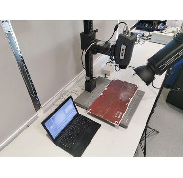

Figure 1. Pulsed Thermography Experimental Setup

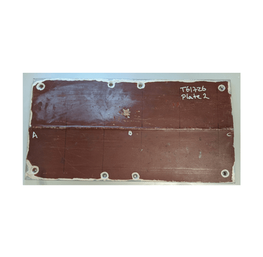

Figure 2. Sample with Defects

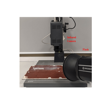

In this case study, pulsed thermographic inspection was performed using a 1 kW photographic flash. This is mainly due to the versatility of the flash – it is portable and easy to use yet can heat up a relatively large area. The infrared camera used was an FLIR A6751 SC and the data was recorded at 125 Hz at full window (640 x 512 pixels) from just before the flash to a few seconds after the flash. In pulsed thermography, the infrared camera will observe the variation in surface temperature of the material as the thermal wave from the heat source propagates through the part. The presence of defects will alter the heat transfer local to the region and hence appear as a region with different temperature distribution, thus allowing sub-surface defects to be detected.
A sample containing realistic defects was obtained from a previous TWI collaborative research project X-Scan (x-scan.eu). The 6 mm thick butt-welded carbon steel plate contained various types of surface and sub-surface defects. The plate was coated with a layer of paint.

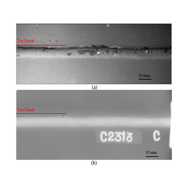

It was found from experimentation that the highest thermal contrast exists a few frames after the flash. However, this is expected to vary with the depth of the defect or coating thickness. For one of the defects in the plate – a toe crack that is sub mm in width and approximately 40mm in length – the defect was visible with sufficient contrast even without post-processing. The results were validated with the radiograph of the plate, which clearly showed the presence of the toe crack at the same location.
Figure 3. (a) Pulsed Thermography result (b) Radiography result
