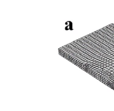

Figure 1. a) Initial weld model, b) test specimen model following cutting

  • A sequentially coupled thermo-mechanical analysis of the fillet welding was performed on the weld plate shown in fig. 1a. The numerical fillet weld model was then cut to the dimension of a mechanical load model as shown in fig.1b.

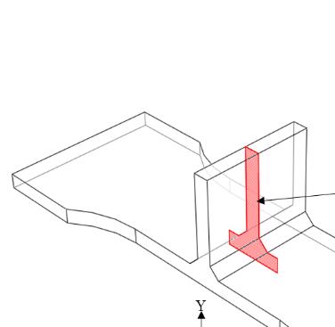

  • Neutron diffraction ENGIN-X instrument at the UK’s ISIS pulsed neutron source was used to determine residual stresses in the initial state and after different load cycles at 30 locations in the plane shown in fig.2.

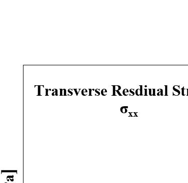

Transverse residual stress distribution on the base plate: results found that after three loading cycles, the maximum value of tensile transverse residual stress at 2.5mm below the top surface is 237 greater than that in the as-welded condition.  However, the maximum tensile stress at 2.5mm above the bottom surface is similar to the as-welded condition and after one and three loading cycles.  See Figure 3.

Figure 2. Neutron diffraction measurement plane

Figure 3. RS redistribution across the weld at 2.5mm above and below the bottom and top surfaces respectively
