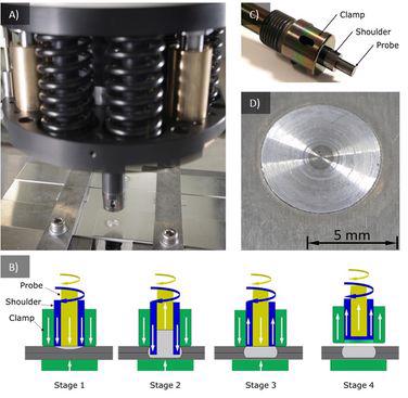

Refill friction stir spot welding (Refill FSSW) has several advantages over other mainstream single-point joining or fastening processes. As a solid-state process producing forged microstructures, refill FSSW joints generate minimal residual stresses/distortions, whilst completely avoiding the common defects associated with fusion welding, such as porosity and solidification cracking. Refill FSSW is also a zero-mass adding technology, as no material is added to the weld. The flush surface finish (Fig. 1D) is highly desirable for applications where aerodynamics and aesthetics are critical factors.

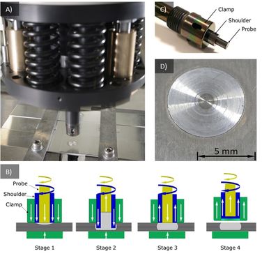

Figure 1.
A) Refill FSSW head (on TWI’s robotic arm)
B) Schematic of refill FSSW process
C) Refill FSSW tool assembly
D) Near-flush surface finish of refill FSSW
Figure 1. A) Refill FSSW head (on TWI’s robotic arm) B) Schematic of refill FSSW process C) Refill FSSW tool assembly D) Near-flush surface finish of refill FSSW
