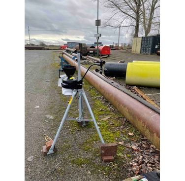

Large-scale environmental tests were carried out over 6-months whereby the Wrapsense technology was installed on a ten-metre section of representative steel pipe and subjected to 6-months of winter weather. The pipe, a 300mm OD steel pipe, was fitted with ten 1-metre long sensors and connected to an IoT controller unit to transmit data from the sensors hourly. Meanwhile, a wireless weather station was installed alongside the pipe to correlate conditions including temperature, wind direction, wind speed, rainfall and humidity as well as any environmental damage to the sensors’ readings, to ultimately assess the sensors’ performance.

The weather station data showed that the maximum temperature recorded was 29°C on 14 June at 13:45 and the minimum was -5°C on 11 February at 2:00. Humidity, rainfall and wind speed were also measured, revealing that wind speed showed no measurable trends across the six-month period.

Figure 1. (left) Pipe before installation (right) WrapSenseLD installed with Weather Station
